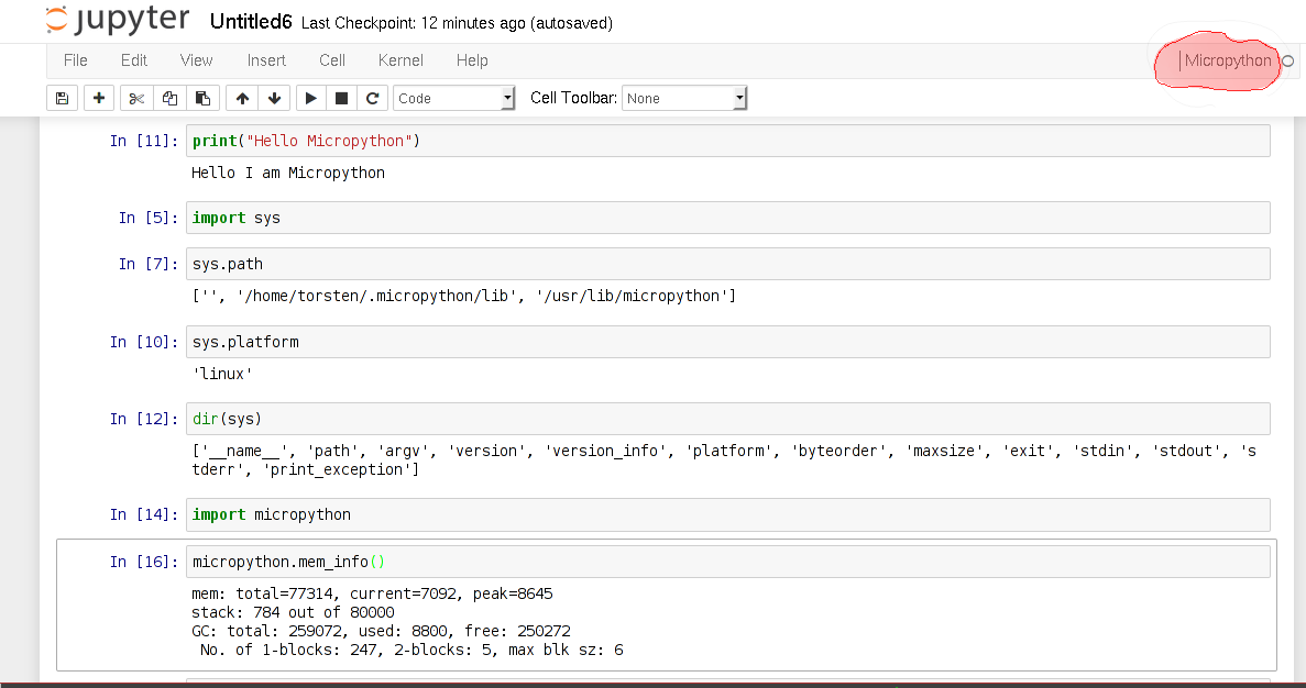

I was looking for an way to use micropython and the pyboards in classes.
There are some challenges:
1. Students are not always comfortable with the command line.
2. Creating a more interactive teaching environment, that is theory together with interactive code.
3. Being able to share and access within a classroom network.
All those points (and many more) are on the list for ipython. Thus, I was wondering if there is a way to use micropython within ipython. I read a bit and luckily this seems to be easier as expected.
Below you see the very first ipython notebook talking to an micropython kernel.
Be aware that this version of micropython is the unix port running on the host PC. Thus, next steps will be to access a micropython running on a pyboard.
After that we should have a nice set of possibilities. E.g. students can access a pyboards attached to other PCs, web-based interactive programming at a low hardware level, creating of course-materials which can interactively access a pyboard for hand-on experiments. I also want to add to save a ipython session directly on a pyboard, thus after an session of interactive fiddling, testing and debugging, one could load the final result on the pyboard to execute it standalone.
This is just the very beginning, there is a lot of room for further improvements like code completion, interactive plots of e.g. ADC data. However, it is a start. I will try to get the pyboard working next and after that one can think of more whistle and bells. Building on the shoulders of giants here... thanks to Micropython and ipyhton, I am just adding some glue

Sweet.
I just started playing with IPython notebooks and was thinking along the same lines.
Are you planning on documenting how you set this up? I know I would definitely be interested in playing around with this.

naa, I thought of keeping it closed source and selling it for big money ;)
As soon as I come to a stable and usable point, including adressing a micropython instance on a pyboard, I will create a repository on github...
If by time, Damien and the dev gang find it useful enough, we might could consider to ship it together with micropython.
Features I want to add after being able to talk directly to a pyboard are,
* code completion (since micropython libs are sometimes only a subset of the equivalent pc libs, this proves to be very valuable during interactive use)
* export the ipython notebook to the pyboard: This is not as easy as it might require source code changes in ipython, something I would like to avoid.
* process in and outgoing data within ipython: this is again part of the micropython kernelwrapper and would allow e. g. to directly draw a matplotlib-based plot for incomming ADC data.
Maybe we can have knobs and sliders for outgoing data too. Need to check on this.
As said in the first post I aim to create an interactive course material learning to use python and with the help of micropython and the pyboard to work on topics like embedded data processing, e. g. implementing a PID control algorithm on the pyboard, controlling a real world system (sitting right on the bench beside the student)
