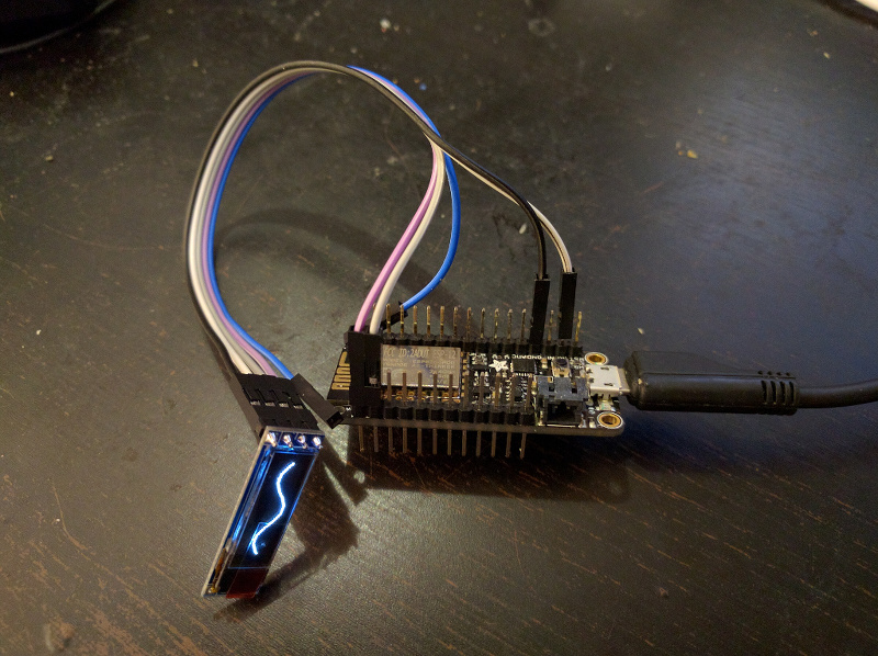

I just tested a small I²C SSD1306 display with the driver that is now included in drivers/display, and it works flawlessly:
This is the result of the following code:
import ssd1306
from machine import I2C, Pin
import math
i2c = I2C(sda=Pin(4), scl=Pin(5))
display = ssd1306.SSD1306_I2C(32, i2c, 60)
display.fill(0)
for x in range(0, 96):
    display.pixel(x, 16+int(math.sin(x/32*math.pi)*7 + 8), 1)
display.show()
