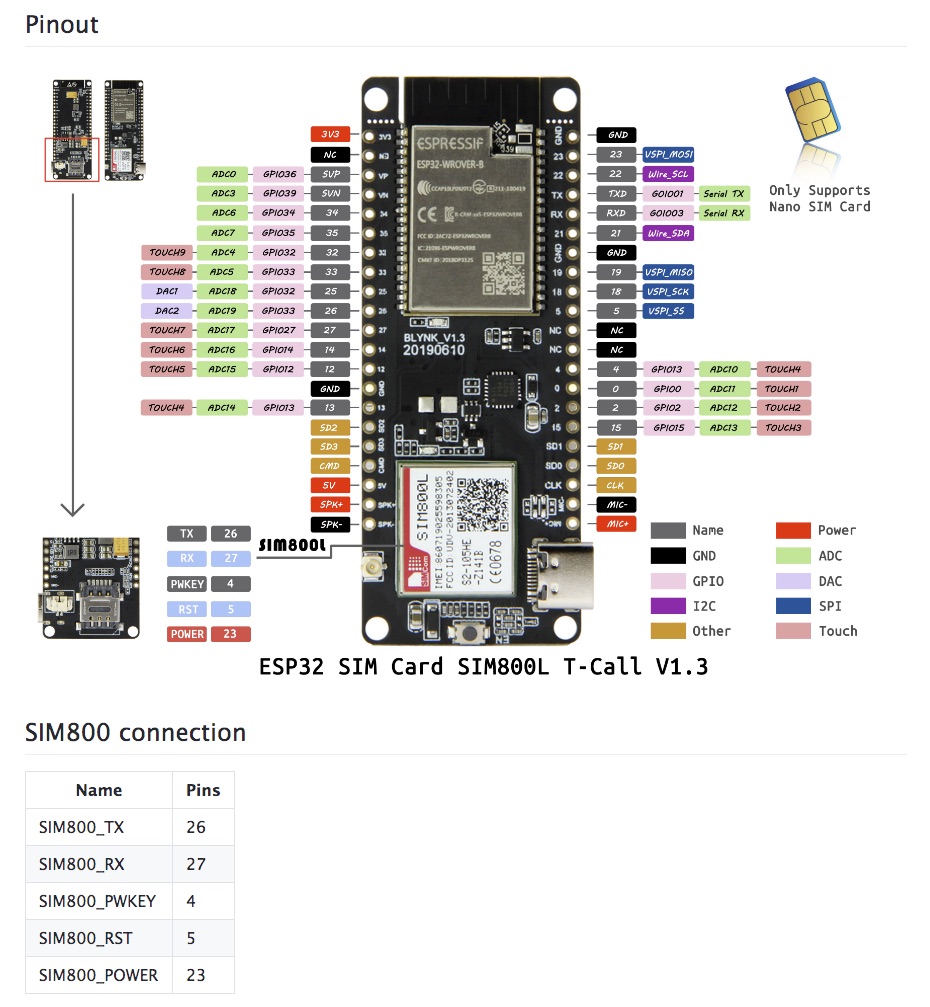

Could you please give the wiring you use? I'm trying to make it with a board like this but with no luck:

Provided that I am not an hardware expert, there is the wiring schematic on the GitHub page of the board I am using: https://github.com/Xinyuan-LilyGO/TTGO-T-Call (I attach a screenshot just in case).
When I started working on SIM800L wiring a few weeks ago, I noticed a lot of confusion online in respect to TX and RX - keep in mind that RX for the SIM800L it TX for the esp32 and vice-versa. I was doing that wrong in the beginning.
T-Call pinout from GitHub.jpg (207.86 KiB) Viewed 92354 times

I've managed how to do it:
SIM800L EVB 5V - to external 5V 2A power source +
SIM800L EVB GND - to external 5V 2A power source -
SIM800L EVB VDD - to ESP32 3.3V + Pin
SIM800L EVB TXD - to ESP32 RX Pin
SIM800L EVB RXD - to ESP32 TX Pin
SIM800L EVB GND - to ESP32 GND Pin
SIM800L EVB RST - to ESP32 23 Pin (any pin, we use it for power on/of SIM800L)
