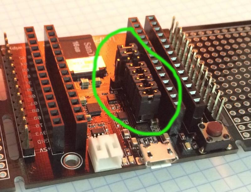

Then I noticed people posting images of the expansion board with a bunch of jumpers on it, while mine doesn't come with any jumpers.
Looking at the designs https://github.com/wipy/wipy/tree/maste ... Board-v1.2 it appears JP3A , JP3B, JP3C and JP3D should connect the onboard FTDI serial-to-USB to the UART ports of the WiPy board. This might be the reason I get no tty response.
I don't have any electronics prototyping gear at hand now, but I'm going to scavenge some stuff to test this assumption. Can anyone confirm? Are there other features that can be en/disabled by the jumpers?
danicampora
Posts: 342
Joined: Tue Sep 30, 2014 7:20 am
Re: REPL via expansion board USB - missing jumpers?
Post by danicampora » Sat Oct 10, 2015 11:37 am
Yes, you need the jumpers in place. Sorry that yours was shipped without them...
