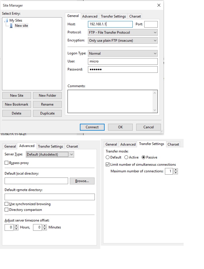

I downloaded Filezilla and am still not able to connect. I get the message:
Status: Connecting to 192.168.1.1:21...
Error: Connection timed out after 20 seconds of inactivity
Error: Could not connect to server
my encryption setting is: "insecure"
any suggestions?
lucien2k
Posts: 24
Joined: Sun Oct 11, 2015 5:34 pm
Re: Missing pyb, serial console and FTP problem.
Post by lucien2k » Fri Oct 30, 2015 7:48 pm
Are you connected to the wipy's wireless network?
Can you ping it?
JimTal001
Posts: 176
Joined: Thu Jul 30, 2015 4:59 pm
Post by JimTal001 » Fri Oct 30, 2015 7:49 pm
I can connect with putty/telnet and I am connected via the wireless network.
I do NOT have the wipy connected via USB to the PC which is running putty or Filezilla.
And Yes I can ping it successfully via the command prompt wirelessly.
lucien2k
Posts: 24
Post by lucien2k » Fri Oct 30, 2015 7:59 pm
I've attached a screenshot of the settings that work for me. It took me a little while to get it sorted (started with winscp, same as you).
