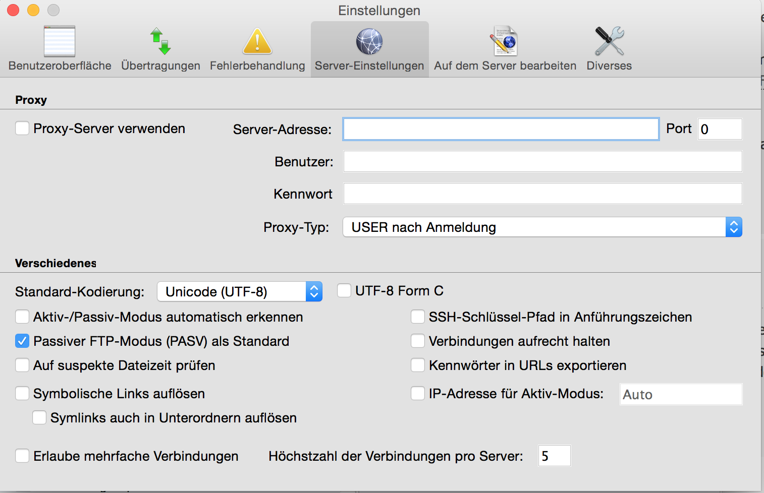

hugohase
Joined: Fri Oct 23, 2015 6:21 pm
Re: Unreliable Operation: FTP, Telnet, Power, ...
Post by hugohase » Fri Oct 23, 2015 6:40 pm
Hallo, same Problem here:
Hallo, just received wipy from Kickstarter.
MicroPython v1.5-1-ge954604 on 2015-10-21; WiPy with CC3200
MAC:
Raw Yosemite FTP -> NO.
Forklift -> NO.
YummyFTP 1.1 MAC APP STORE -> YES. See Pic attached.
Bildschirmfoto 2015-10-23 um 20.37.18.png (224.68 KiB) Viewed 9960 times
