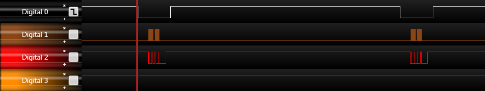

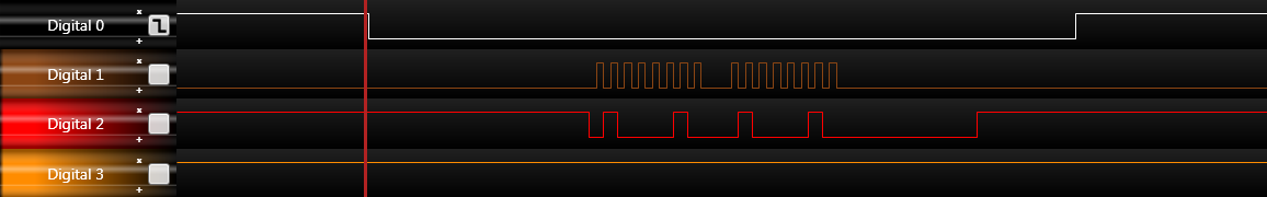

Here are traces recorded by logic analyzer for sending of integer converted to 2-byte payload two times via cashed spi.write method. I believe that there could be some more efficient way how to do the conversion.
class GalvoBoard():
	def _sendGalvoData(self, data):
	    data_bytes = data.to_bytes(2)
	    data_array = bytearray([data_bytes[1],data_bytes[0]])
	    self.spiNSS.value(0)
	    self.spiWrite(data_array)
	    self.spiNSS.value(1)
The test sequence:
    def seqTest(self):
        print("Starting sequence test")
        startTime = time.ticks_ms()
        self.galvoBoard._sendGalvoData(16962)
        print("Scan test ended in %sms" % (time.ticks_ms() - startTime))
And the traces:
Signals: CS/NSS, SCK, MOSI, MISO
As you can see, time difference between those two SPI transfers is really long. Is there anything I could do to make it shorter?
It is necessary to raise CS/NSS pin of SPI slave (2-channel 12-bit DAC MCP4922) to high level after every two transffered bytes.

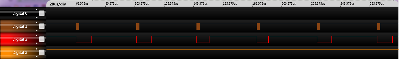

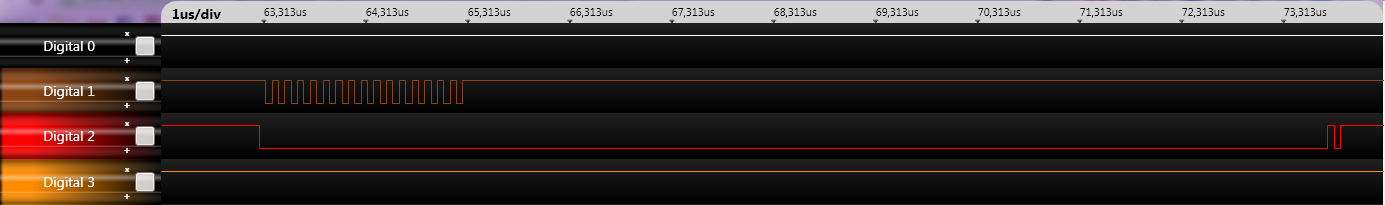

Daniel, I did some more experiments using following simple code in main.py:
import gc
gc.disable
spi = machine.SPI(machine.SPI.MASTER, baudrate=8000000, polarity=1, phase=1, bits=16, pins=('GP14', 'GP16', 'GP15'))
spiWrite = spi.write
	spiWrite(b'\x00\x00')
I omitted switching of CS pin on purpose just to determine raw speed of SPI interface. I set the frequency to 8MHz because of limited sample rate of my logic analyzer. Interface is set to operate in 16-bit mode because this is word width my SPI slave is using.
Here are two traces from the logic analyzer - detail and sequence.
As you can see, time difference between two transfers of 2-byte payload is approx. 42us, which translates to 47,6 kbytes/sec.
In this thread user Oliv suggested to activate DMA mode in WiPy's FW: http://forum.micropython.org/viewtopic. ... ency#p7709
You explained that it is not enabled because of impact to heap space. Could you please elaborate more on how significant the impact would be?
Is it possible to implement some global settings whether to use DMA for SPI at the expense of free heap size?

I'm not convinced DMA would help. It's sending the two bytes quickly: the time is taken executing the while loop. It might be instructive to look at the timing for (fragment):
