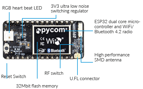

Sounds great but I'd like to know how it achieves a 1KM WiFi range. It seems an astonishing figure if based on the onboard chip antenna and a typical AP with duck aerials. Or is it a special setup with, say, Yagis at both ends of the link?

yet 1Km at 2.4 GHz is 100dB free space loss, so for typical wifi sensitivity in oder to have a budget link and in the absence of antenna gain, this needs a huge power that wil burn all the circuits of such a tiny stuff !!
I may be wrong but then please provide the budget link

So just to clarify about wifi range on WiPy 2.0: are wrong the specification 1KM wifi range on the doc https://www.pycom.io/wp-content/uploads ... wipy20.pdf ? What is the correct (more less) range?
