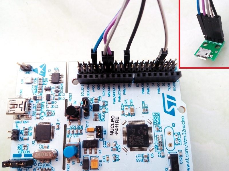

I have port Nucleo_L476RG board, it works fine.ajie_dirgantara wrote:Hi All,
1. Is there any support for this particular board? Currently I've been compile and flash the STM32L476DISC to the nucleo board. Can I use this a a starting point?
2. in STM32L476DISC mpconfigboard.h, the USB options is commented out, how can I copy my .py files?
Thanks,
Nucleo_L476RG has no usb connector for microcontroller, so PYBFlash disk can't be used. But your can connect usb pins in NUCLEO board to a usb connector, then PYBFlash disk can be used.

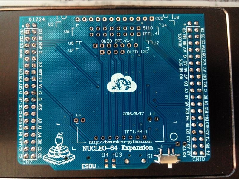

I have also make expansion board, make it easy to use USB and sdcard.

Dear shaoziyang,
Your expansion board is very interesting.
Can you share the design? or where to buy it.

Yes, my design is free. Below is schematic (pdf format), full design file is too large to upload. if you need it, please tell me your email.photoacoustic wrote:Dear shaoziyang,
Thanks in advance
Arouna
I have make several blank boards for myself, if you pay freight, I will send you one.
