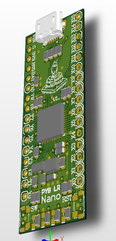

Here is my PYB Nano board, it use STM32F401CE/STM32F411CE.
http://forum.micropython.org/viewtopic.php?f=12&t=2514
