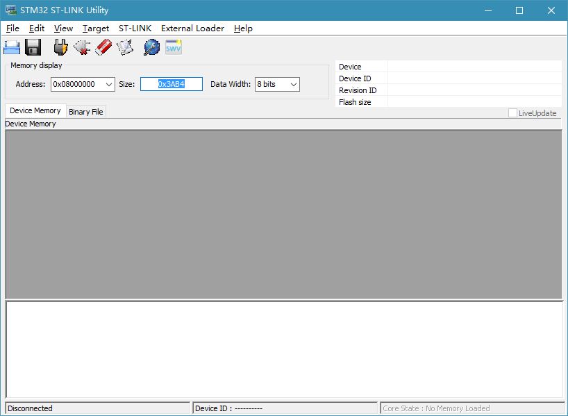

You may using "STM32 ST-Link Utility" to flash bin/hex file to Nucleo board.

Post by shaoziyang » Mon Oct 22, 2018 2:56 pm
