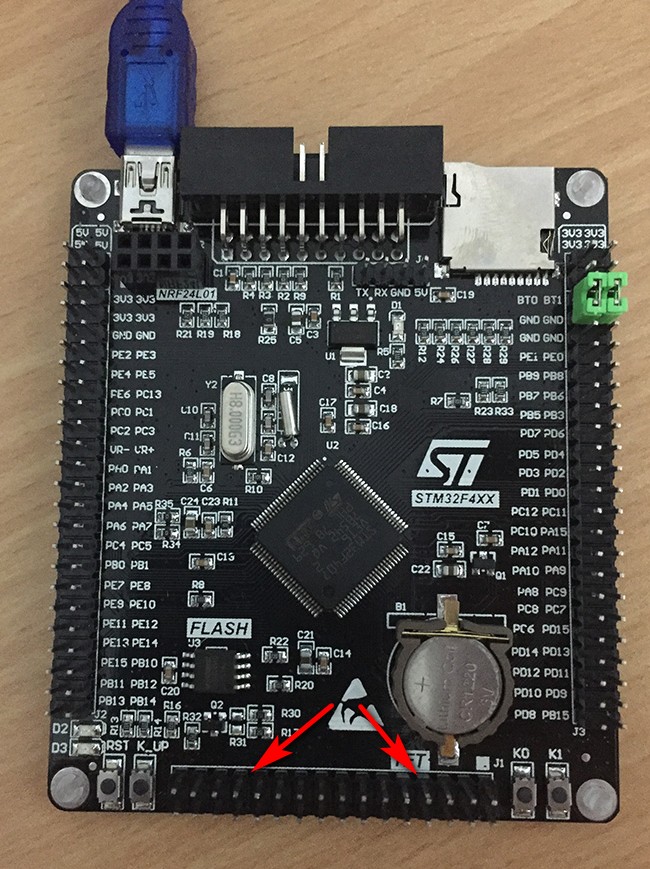

The header directly opposite to the JTAG connector is marked "For mcudev/TFT" -- looks like the parallel LCD bus... is this documented somewhere?

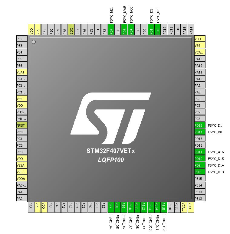

Post by OutoftheBOTS_ » Sat Jun 15, 2019 8:25 pm
The TFT header is a copy of the needed pins on the side to use the 16bit parallel FSMC peripheral.
U can find the TFT pin-out here https://wiki.stm32duino.com/images/a/a8 ... AG-TFT.pdf
And here is a pic of the pins used but the MCU for the FSMC peripheral
ProudPagan
Posts: 35
Joined: Fri Apr 12, 2019 8:55 am
Re: [Black STM32F407VET6] Pin map
Post by ProudPagan » Sun Jun 16, 2019 4:22 am
Thanks, that PDF is what I was looking for!
mcauser
Posts: 507
Joined: Mon Jun 15, 2015 8:03 am
Post by mcauser » Mon Jun 17, 2019 11:12 am
There are also pin diagram images here showing which pins are on the TFT header:
