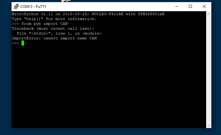

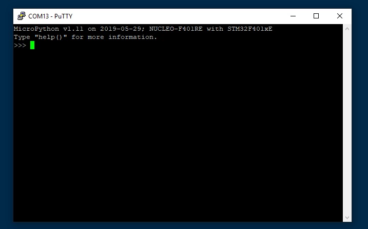

Hello everyone, I have a stm32 F401RE and I installed the firmware Micropython, at least I hope I did .:).Using putty I observed that some modules of pyb are unknown to him . Most of the modules see them, but it gives me error on pin named X1.Any idea?
Even using Thonny same problem.
I attach putty jpeg connected with the card.
Thank you

Post by shaoziyang » Thu Oct 31, 2019 1:27 pm
nucleo F401RE firmware doesn't enable servo default, you can enable it by add
#define MICROPY_HW_ENABLE_SERVO (1)
to mpconfigboard.h and recompile source code.

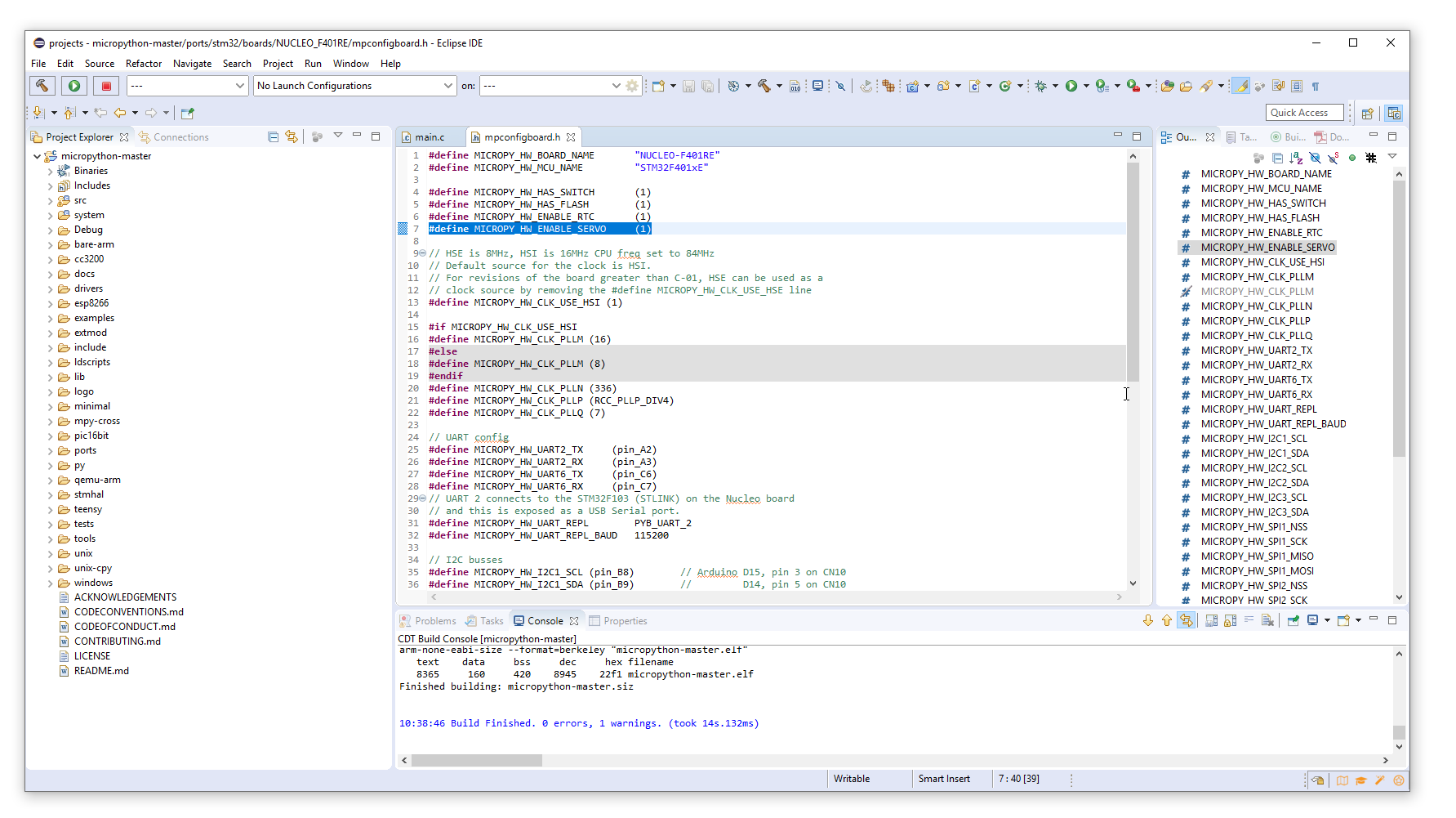

Hello everyone, I'm trying to recompile micropython-master because I would like to add the Servo library that on my F401RE with micropython 1.11 is not implemented. Under shaoziyang's suggestion
I modified the mpconfigboard.h file related to my card joining:
#define MICROPY_HW_ENABLE_SERVO (1).
Now I have loaded everything in Eclipse, with the toolchain, but I did not understand if I have to recompile everything or just some sources.
Thanks
chippx
seems easy...
Eclipse- Micropython-master.png (214.05 KiB) Viewed 5756 times
Re: nucleo F401RE cannot import name Servo
Post by jimmo » Mon Nov 04, 2019 12:09 am
Unfortunately MicroPython is not an Eclipse project. You can edit the files and browse the project in Eclipse of course, but the way to build the STM32 firmware is via arm-none-eabi-gcc and the Makefiles.
The instructions are here: https://github.com/micropython/micropyt ... /README.md
Unfortunately I don't know much about how to do this from Windows... hopefully someone else can chime in. You should just need git, arm-none-eabi-gcc and a way to run the Makefile... perhaps cygwin? Unlike other platforms (like ESP32), the STM32 port has no other dependencies. Try searching this forum, I'm sure other people have done it.
