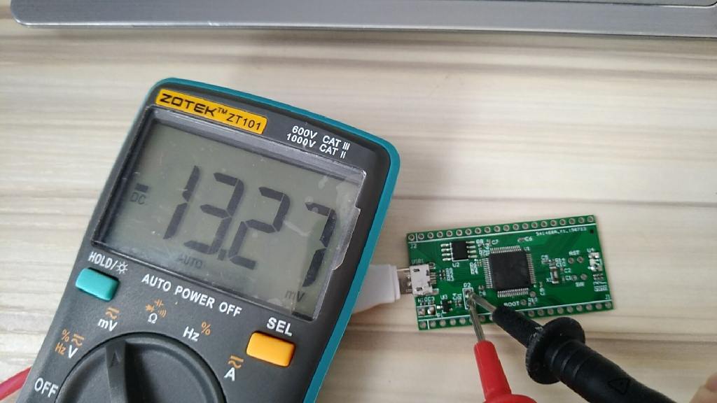

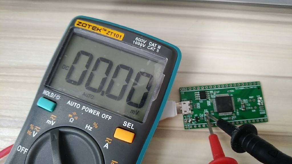

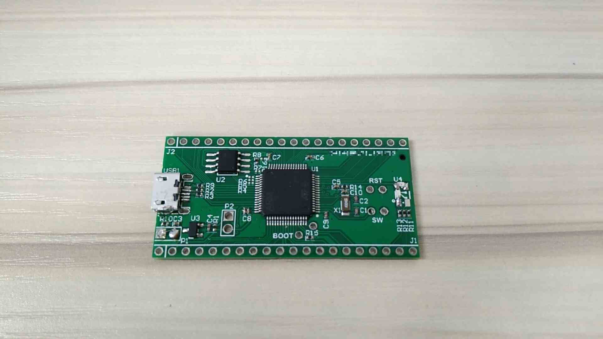

I have made a demo board of STM32L476, to test power consumption in different mode. I have add a 10ohm resistor in vcc, calculating power consumption by measuring voltage in resistance.
demo board
running mode
lightsleep mode
deepsleep mode (below 1uA)

Cool, that would be:
9.54 mA in normal running mode
1.32 mA in lightsleep mode ?
What was the system clock setting ?
Which Micropython FW did you use for testing ?
