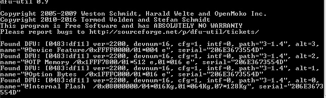

bellad
Posts: 96
Joined: Tue May 14, 2019 1:47 pm
Re: MCUDev Black STM32F407VET6 + STM32F407ZET6 dev boards
Post by bellad » Mon Jun 22, 2020 7:26 am
hello,
i have put BLACK_F407VE-20170620-v1.9.1-29-g1686346.dfu on my card with dfusedemo with bt0-3.3v
it's ok
after bt0-gnd , i plug usb and
unknown device
d2 d3 toogle and after nothing
i have not st-link , it's possible with usb ?
how to switch to repl mode by usb ?
for RPEL mode use usb J4 or rx tx > usb J6 ?
thank
i wiork with windows7
vahithosan
Posts: 19
Joined: Wed Jul 26, 2017 5:15 pm
Post by vahithosan » Tue Jun 23, 2020 6:32 am
hello,
it's ok
unknown device
thank
it happened to me too.
viewtopic.php?t=3313#top
dfu-util -s :mass-erase:force -a 0 -d 0483:df11 -D path-to-some-dfu-file.dfu
0483:df11 replace your own device
bellad
Posts: 96
Post by bellad » Tue Jun 23, 2020 8:03 am
ok , thank , but it's same
i have put
STM32F4DISC-20200622-unstable-v1.12-557-g3a9d94803.dfu
it's ok , except when i do CTRL-D no reset , he crashes
when
dfu-util -s :mass-erase:force -a 0 -d 0483:df11 -D BLACK_F407VE-20170620-v1.9.1-29-g1686346.dfu
cannot open dfu 0483:df11
ok i have put driver zadig
after put , with BT0 on 3.3v
after BT0 on gnd
it's same , no acces REPL
