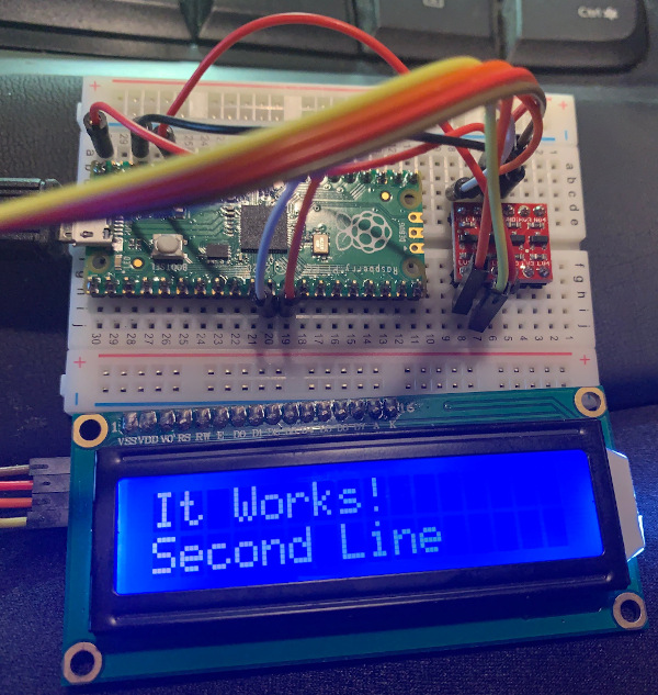

Post by dhylands » Tue Feb 23, 2021 9:15 pm
I created the following 2 files:
https://github.com/dhylands/python_lcd/ ... i2c_lcd.py
https://github.com/dhylands/python_lcd/ ... cd_test.py
which I tested on my RPi Pico using a SparkFun voltage converter: https://www.sparkfun.com/products/12009
