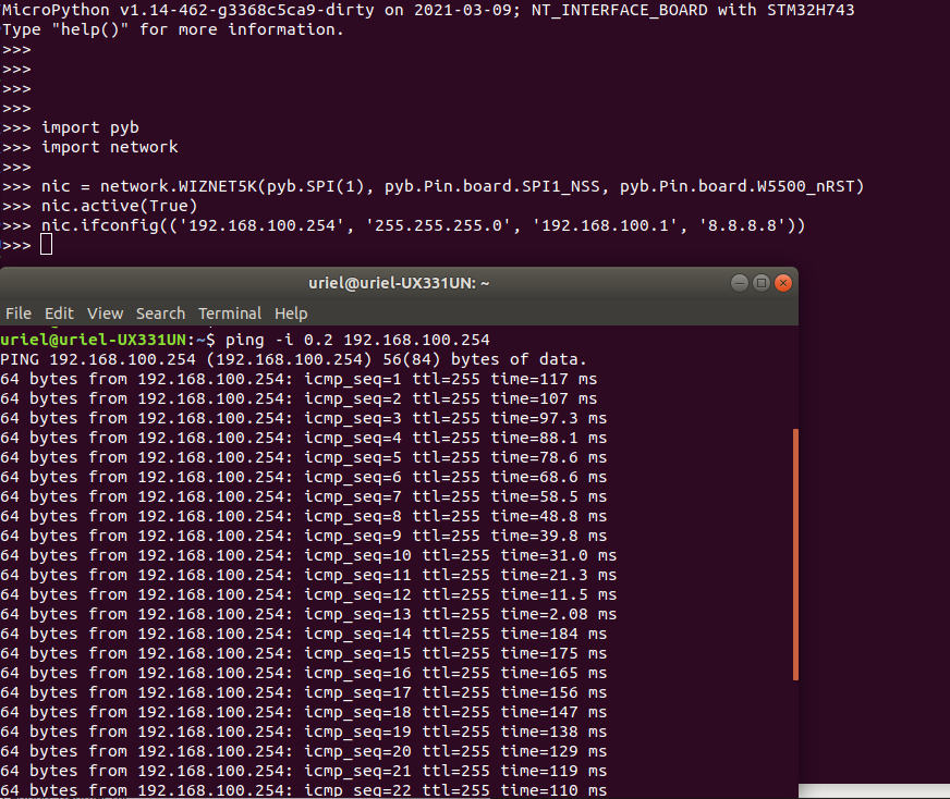

I am running micropython 1.14 (happens also on 1.9) on the NUCLEO-H743ZI dev board (compiled using the board definition in micropython, no further changes) connected to a W5500 shield.
The issue I am seeing is some kind of delay when sending UDP packets and also when just pinging the board.
The ping goes from 1ms to 200ms and it seems to be cycling (like there is some fixed polling or something), going down and up:
Connecting the same shield to Arduino Uno yields the correct behavior, ping is 0.2ms:

I changed LWIP_TICK in stm32/ports/modnetwork.c to be every 50ms instead of 128ms and now it looks like this:
WhatsApp Image 2021-03-15 at 10.57.19 AM.jpeg (143.13 KiB) Viewed 8788 times
So it seems the issue stems from the fact that the W5500 implementation is using polling instead of interrupts, why is that? what is the recommended solution for this?
