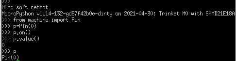

Hi there,
I'm progressing on the implementation... I just compiled a living SAMD21 MicroPython with Pin class declaration.
Did not work with C since my 25 (I'm also 50 now)... OMG... so hard!
Now, I still need to connect pipes.... but that's promising
