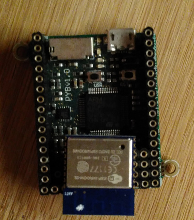

deshipu wrote:So I tried to make a quick and dirty mockup of such a PCB in Fritzing (http://fritzing.org). The first problem I had is that the WROOM-02 board is too wide to fit between pyboard's pins....
Cool, thanks. But it should be possible to fit it on a board of that size...
Re: Suggestions please: ESP8266 "Base"-Board with pyboard Footprint
Post by deshipu » Mon Sep 12, 2016 7:40 pm
Hmm, ok then, it seems that the footprint of it that I found was wrong. No problem, we can just use 2mm pitch pin headers in that place, and solder the module to that.
The real problem is which gpio pins should go where. Any ideas? I can update and clean up the design then.

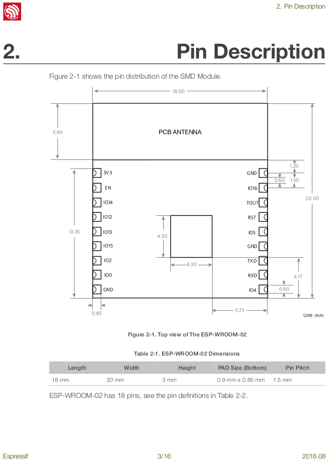

deshipu wrote:Hmm, ok then, it seems that the footprint of it that I found was wrong. No problem, we can just use 2mm pitch pin headers in that place, and solder the module to that.
Check the attached screenshot from their datasheet... It is a 1.5mm spacing i'd say.

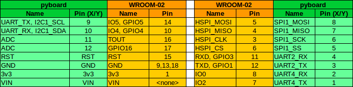

Post by kfricke » Mon Sep 12, 2016 8:54 pm
deshipu wrote:... The real problem is which gpio pins should go where. Any ideas? I can update and clean up the design then.
How about this?
Untitled 1 - LibreOffice Calc_002.png (29.7 KiB) Viewed 7982 times
