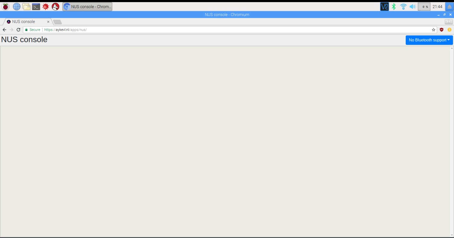

I suddenly remembered that my raspberry pi 3 has bluetooth built into it, so tried it. Same result:
Furthermore, the raspberry pi's bluetooth can see the "mpus" device, but it can't pair with it.

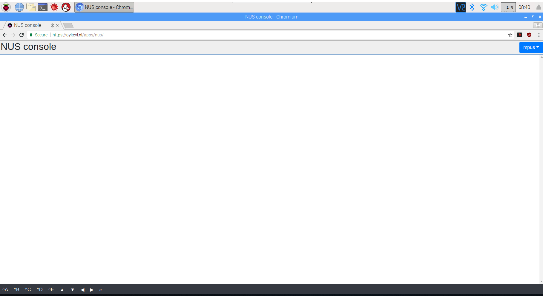

Thank you. No, I hadn't. So, doing that, I do get further:
However, now nothing I type into the NUS console gets echoed back, and I also don't hear anything from the nRF52-DK that it has connected to over Bluetooth.
So, though I definitely seem to be getting closer, still no joy yet. What should I do next?
