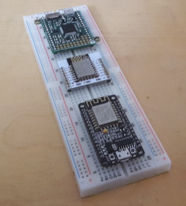

deshipu wrote:
SpotlightKid wrote:The Pyboard form factor also isn't very friendly to breadboarding. If you solder male pin headers to it and stick it in a breadboard, it covers all the middle lanes and leaves no place to plug you jumper wires or other components.
The trick is to put the pins in the middle on top, and only put the two rows on the sides on the bottom.
I'm not sure, whether you understood what I meant: the pyboard covers all the ten middle lanes (or rows, if you will) of a normal breadboard. See photo:
Re: Suggestions please: ESP8266 "Base"-Board with pyboard Footprint
Post by deshipu » Tue Sep 13, 2016 11:30 am
Ah, I see what you mean now, sorry, I'm not very used to breadboards -- usually I prefer to use female dupont cables for the connections directly, but that's because I usually work with whole modules, and not individual components. One workaround for this that I have seen is to use two breadboards side by side, but that is of course suboptimal.
SpotlightKid
Posts: 463
Joined: Wed Apr 08, 2015 5:19 am
Post by SpotlightKid » Tue Sep 13, 2016 11:33 am
deshipu wrote:One workaround for this that I have seen is to use two breadboards side by side.
Yes, that's what I usually do.
Post by pythoncoder » Wed Sep 14, 2016 6:35 am
Fit the Pyboard with stackable female headers on the long sides, normal female headers at the end. Plug into breadboard. Job done. ;)
