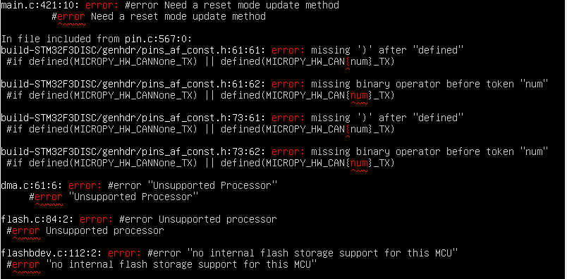

Now I got stuck here:

The problem in main.c is that the code wants a way to interact with the user for doing the various resets.
MICROPY_HS_HAS_SWITCH is defined, however it seems that neither MICROPY_HW_LED2 nor MICROPY_HW_LED1 is defined.
Looking at the mpconfigboard.h file I see lots of LEDs defined. I'm assuming that you chose LED numbers that match what's on the board. The micropython code wants LED1 thru N. I'd probably create definitions for 1 and 2 which map onto 2 of the other LEDs.
The other problem appears to be a bug in the make-pins.py script. As a temporary workaround, you can comment out these 2 lines:
https://github.com/sfynxu/stm32f3discov ... ins.py#L20
https://github.com/sfynxu/stm32f3discov ... ins.py#L30
I'll see what needs to be changed so that make-pins.py works for the F3.

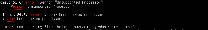

Now seems to be and error of dma, flash, ... and I stoped the script to get the screenshot.

Re: STM32F3 ports
Post by dhylands » Sat Feb 09, 2019 4:24 pm
The following change will fix make-pins.py to work properly with the F3. Change the function condition_var (line 58) from this:
def conditional_var(name_num):
    # Try the specific instance first. For example, if name_num is UART4_RX
    # then try UART4 first, and then try UART second.
    name, num = split_name_num(name_num)
    var = []
    if name in CONDITIONAL_VAR:
        var.append(CONDITIONAL_VAR[name].format(num=num))
    if name_num in CONDITIONAL_VAR:
        var.append(CONDITIONAL_VAR[name_num])
    return var
to this:
    var = []
    if num is None:
        # Covers the case where name_num is CAN instead of CAN1
            var.append(CONDITIONAL_VAR[name].format(num=''))
    return var
The issue is that the F3 only has a single CAN peripheral, so the pins are named CAN_TX but the script was expecting CAN1_TX.

Ok. Applied patch. Returned to old _af csv (with CAN, not CAN1).
Updated repository.
Can't figure out if F3 has DMA_Stream or DMA_Channel ...
Re: STM32F3 ports
Post by dhylands » Sat Feb 09, 2019 4:44 pm
A quick grep in the HAL directory shows lots of references to DMA_Channel_TypeDef and none to DMA_StreamTypeDef
romeo
