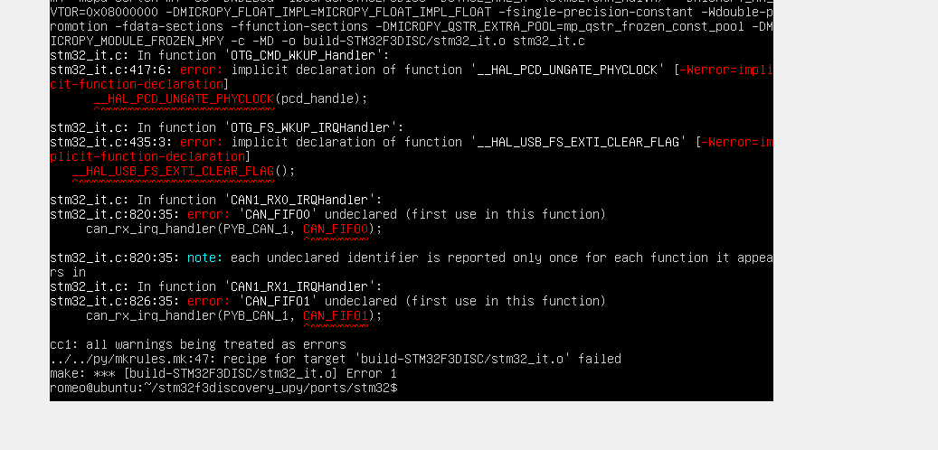

Post by romeo » Mon Feb 11, 2019 7:10 pm
Solved one!
Got another error!
Thanks,
Romeo
Re: STM32F3 ports
Post by dhylands » Mon Feb 11, 2019 8:57 pm
It looks like you need to add the following line to ports/stm32/Makefile:
CFLAGS_MCU_f3 = $(CFLAGS_CORTEX_M) -mtune=cortex-m3 -mcpu=cortex-m3
in this block: https://github.com/micropython/micropyt ... kefile#L71
Make sure you do a clean, because all of the objects will have been built for the wrong MCU.
Then you'll run into a few more issues in stm32_it.c that aren't as straight forward.
For the first error, I think that you just need to add __IO to the extern declaraion of uwTick.
For the issues that I see you'll need to see what the macros do on the F4 and then see if there is equivalent functionality on the F3 by comparing datasheets. It's possible that you'll need to add some #if's or something.
For the CAN stuff I suspect that the CAN peripheral is slightly different between the F3 and F4 and so will most likely require some #ifs
For any changes you make to stm32_it.c you'll want to try build for some other boards to make sure that they continue to work.
romeo
Posts: 25
Joined: Mon Jan 28, 2019 5:57 pm
Re: STM32F3 ports

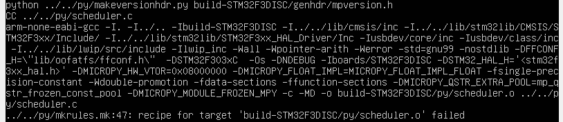

Post by romeo » Tue Feb 12, 2019 8:46 pm
I made one step forward, but still in error!
Can't figure out what should be in here!
I've tried to compare with files on st.com ... but it doesn't seem to work!
Any ideas?
Thanks,
Romeo
Re: STM32F3 ports
Post by dhylands » Tue Feb 12, 2019 10:16 pm
The F3 doesn't have a PHY control, so I'd put
#if defined(__HAL_PCD_UNGATE_PHYCLOCK) // Not available on the F3
around that line.
For the others, I disabled USB and CAN and then it gets further. The USB peripheral on the F3 looks to be totally different from the F4, so I suspect that quite a few changes will be required to support that.
romeo
Posts: 25
Re: STM32F3 ports

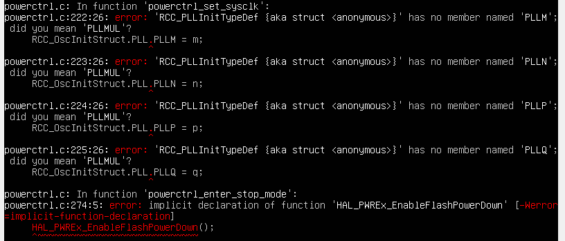

Post by romeo » Wed Feb 13, 2019 7:27 pm
Ok. Tried that. Still the errors appears!
Thanks,
Romeo
Re: STM32F3 ports
Post by dhylands » Wed Feb 13, 2019 10:39 pm
The PLL portion seems to be different between the F3 and the F4, so you'll need to change things to work with the F3.
