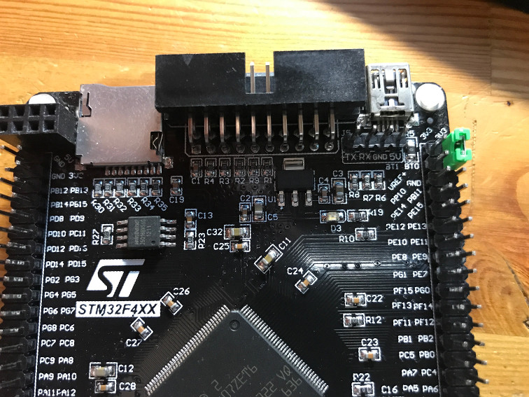

The pinout on my board is different from yours, but yes, BT0 is attached to 3V3:
https://i.imgur.com/Vm6711V.jpg
I am using linux (debian 4.12.0-1-amd64), and lsusb does not show the device, with syslog showing the " usb 1-1.2: device not accepting address 89, error -32" and " usb 1-1-port2: unable to enumerate USB device" messages every time I plug the board in.
I think that the board is really defective. I will try to contact the seller.
Anyway, thank you very much for your answers.

The pinout difference is your board is a VET6 and dhylands photo is a ZET6.
VET6 has the Micro USB port on the top left, ZET6 top right.
Both have boot pin jumpers in the top right.

Ok, the board was, indeed, defective. Got another one, up and running. Thank you.
