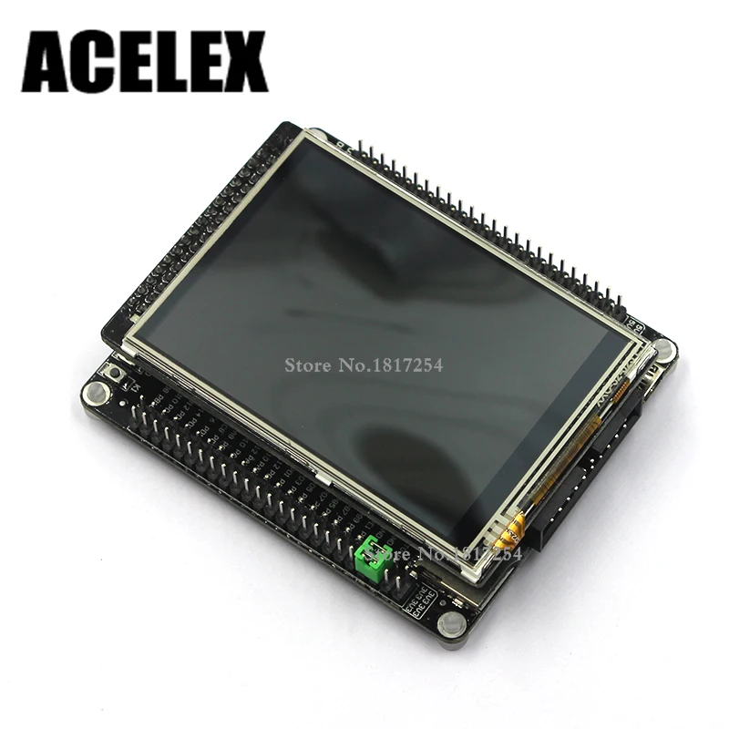

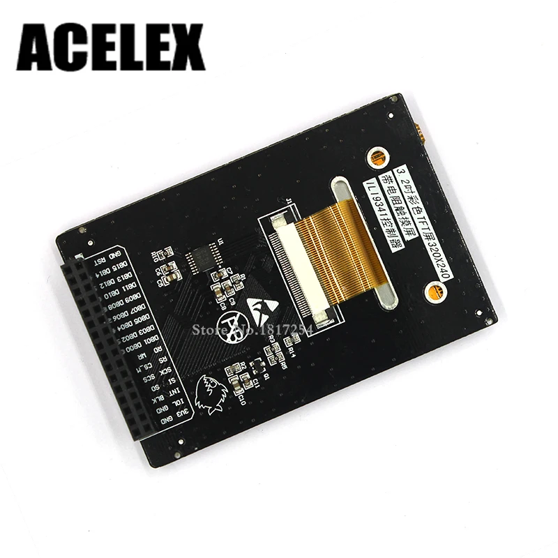

Dear All,
I would appreciate any help you guys can provide for hooking up the Black STM32F407VE6 to an 3.2 TFT LCD.
As far as I am aware the STM32 board and the LCD are produced by the same company (Acelex) and it looks like the pinout of both, board and LCD match.
The LCD is advertised by the seller as matching LCD for the STM32 board. It has FSMC parallel interface and is using XPT2046 touch controller talking over SPI . https://www.aliexpress.com/item/3-2-inc ... 35059.html
The STM32 board is discussed in this thread viewtopic.php?t=3086 and
the board def. files are made available by mcauser in githib: https://github.com/mcauser/BLACK_F407VE
I would appreciate any code or at least pointer on how to start with this LCD.
P.S. I have searched the forum but couldn't find anything that I can use.

I think you need external SDRAM for use the display (available on ZET6 boards).
You can analize this code, there are examples of using LCD.
I have MicroPython running good on STM32F407ZET6 board. I'm also planning to get this diplay board and test it with MicroPython next month...

I have checked the feedback left by the customers who purchased this LCD. Some of the comments suggest that the LCD works fine with the VET6 variant and also suggest that the LCD was tested and works with Arduino. At the moment, I am trying to find a library that works with Arduino so, I can verify the LCD works.
I will keep you updated...

I don't think that you need an external SD RAM, the TFT has already RAM for the frame buffer. I made a driver for a SSD1963 display with similar interface for Pyboard. https://github.com/robert-hh/SSD1963-TF ... or-PyBoard. It is not very portable, since some part is written as assembly code, and it uses fixed ports.
There is also a XPT2046 driver. https://github.com/robert-hh/XPT2046-to ... or-PyBoard. That should be portable.
Maybe that is useful for you purpose. I had plans to add support for the IL9341 too, but did not find time yet to do so, It should nto be too difficult, just have to get a suitable TFT.

Got the LCD working with the Arduino IDE.
See http://stm32duino.com/viewtopic.php?f=3 ... 685#p35685
Now, it is way above my abilities to port the library to micropython but if anyone wold try I will be happy to assist as much as I can.
