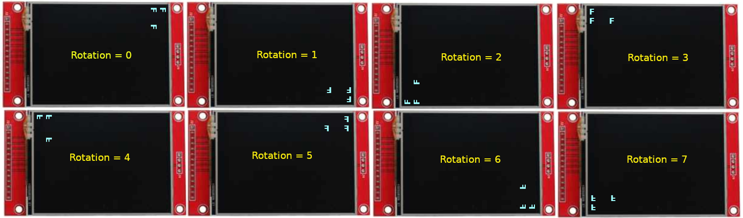

Hi, do you know will the driver work with this 2.8″ Touch LCD SPI display? If so how to set up SPI pins in ESP32 DEVKIT V1?
UPDATE: I got it working with following test (with some complains from SPI driver):
import ili9341
vspi = SPI(2, baudrate=32000000, miso=Pin(19),mosi=Pin(23), sck=Pin(18))
display = ili9341.ILI9341(vspi, cs=Pin(2), dc=Pin(27), rst=Pin(33))
display.fill(ili9341.color565(0xff, 0x11, 0x22))
display.pixel(120, 160, 0)
vitalis
Posts: 8
Joined: Fri Nov 29, 2019 6:04 am
Location: Finland
Re: ILI9340/ILI9341 TFT Display
Post by vitalis » Mon Dec 02, 2019 8:41 pm
After playing with rotation parameters of ILI9340/ILI9341 TFT controller I got the display working with esp32 devkit1.
I made a pull request to micropython-ili9341 project:
1. New API for display initialization - Width, Height and Rotation:
display = ILI9341(spi, cs=Pin(2), dc=Pin(27), rst=Pin(33), w=320, h=240, r=0)
2. Rotation parameter effects (0 - 3: rotation; 4 - 7: mirroring+rotation):
