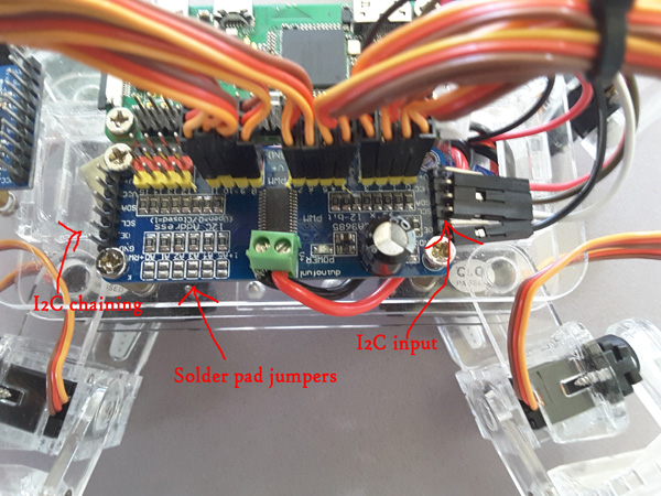

currently the address that you use for the PCA9865 is _ADDRESS = 0x40 but this address is select-able for the PCA9865. Most servo boards that use this chip will have solder pad that you jump to change the slave address (they work like binary numbers). If you want to use more than 1 board at a time then you just change the slave address of each board with the solder jumpers and in your software you just have to address each board. Most of these servo boards also have 2 sets of pins for connecting the I2C so that it is easy to daisy chain them together see attached pic

you would just need to change a couple of lines of code for the address to be select-able
def __init__(self, aSDA, aSCL, slave_address=0x40)
  self._ADDRESS = slave_address
This would then use the default address of 0x40 but allow the user to use a different address if they need
