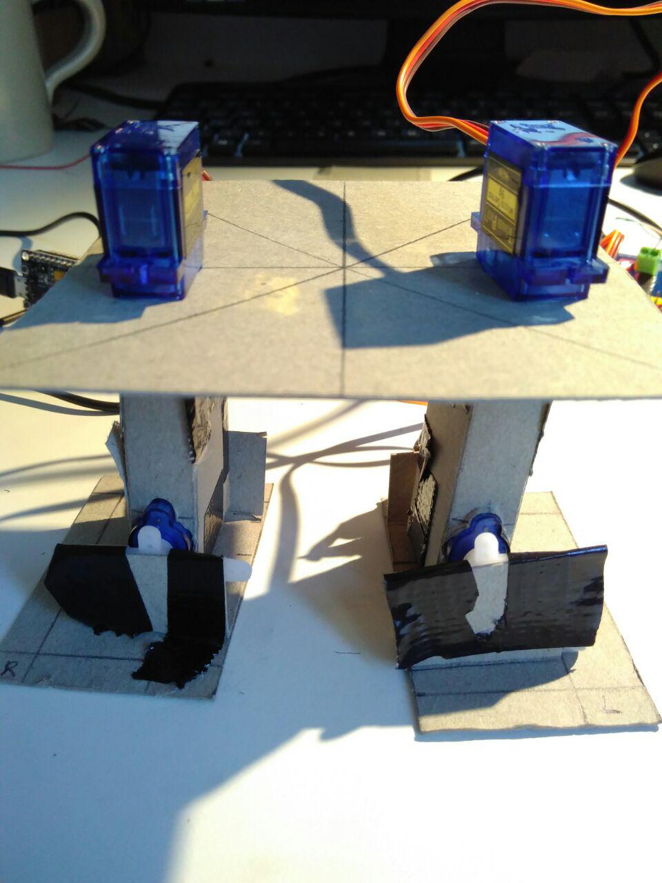

I got also an idea to use the PCA9865 shield with a ESP8266 to make a uPython Version of oTTo DIY.
Since I don't have a 3D printer or a Laser Cutter I used cardboard and tape (so it look very crappy - sorry for that).
While the libraries from adafruit are pretty helpful, I struggled to make my two robot legs move more than up an down.
At oTTo DIY GitHub repository are some Ardurino codes, but I am not able to understand them good enough to turn them into uPython code (at which I am as well only a beginner). Especially the oscilloscope stuff is fare above my understanding.
Thank you in advance for any advises.
[And yes I used degrees instead of radians.]

- Posts: 847
- Joined: Mon Nov 20, 2017 10:18 am
Re: PCA9865 16 servo controller board using I2C.
Nice project
I make my kids build their projects out of card board first and if they can make therm work but discovering all their mistakes then I let them laser cut them. I get them to print out their designs on paper then stick the printer paper on card board and cut it out.
I clicked on the repository and there is quite a bit of code there. I would assume it has built up over time. It will also take you a fair bit of time to build up your MP code to do the same.
U have a couple of options: 1. try to port across the Arduino code. 2. write your own code by watching the videos to understand the needed behaviors and use the Ardunio code to give you ideas.
I personally like to do the second option, see something someone else created and use it to inspire me to make my own creation.
I do have it on my list to build a humanoid robot but am very busy with other projects ATM so it is likely to be a little while before I get to it. I say the otto and I also saw this https://www.youtube.com/watch?v=0R4U8iCmMJI and planned to make something somewhere between the 2.
