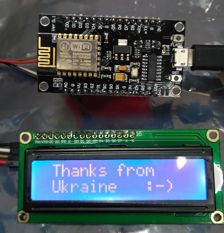

Re: I2C LCD Library... Help!
I soldered all pins from LCD to backpack and now all is ok.
Thanks for troubleshuting. >>> from esp8266_i2c_lcd import I2cLcd
Question: Can we tune "Brightness" and "Contrast" using I2C LCD Library?
I ask this question because of next problem...
When I use wrong connection and power LCD Backpack (5V) from NodeMCU VU pin (5V) - all is ok with "Brightness" and "Contrast". See my picture above. But such connection may faulted I2C pin on NodeMCU (not 5V tolerant).
When I power LCD Backpack (5V) from NodeMCU 3V3 pin (3.3V) - LCD is working BUT "Brightness" and "Contrast" too low. I set potentiometer on Bacpack to max position. I can lcd.putstr('hi") but it very hard readable.

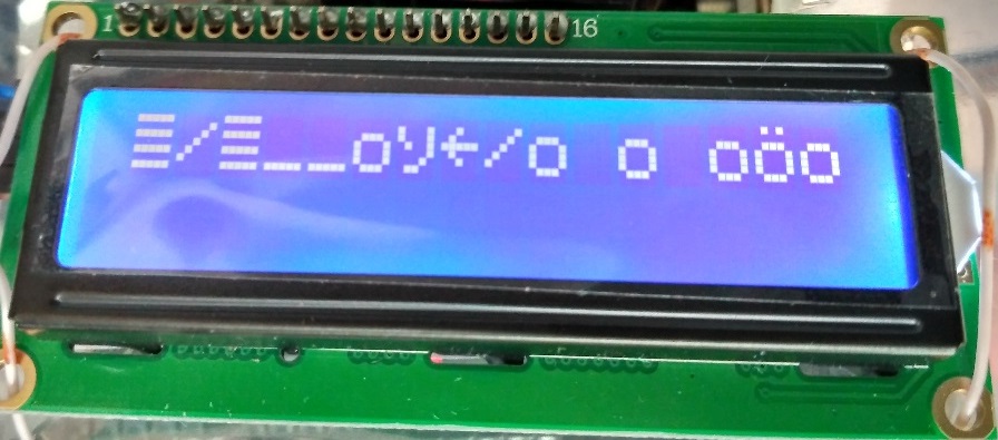

Test.
Power LCD Backpack (5V) from NodeMCU 3V3 pin (3.3V).
>>> i2c = I2C(scl=Pin(5), sda=Pin(4), freq=100000)
>>> lcd = I2cLcd(i2c, 63, 2, 16)
>>> lcd.putstr(' Thanks from Ukraine
Than I disconnect 3V3 pin and connect it again to 3V3 pin
"Brightness" and "Contrast" is ok but Char is wrong.
When I reinitialize LCD+Backpack
Char is good but "Brightness" and "Contrast" is too low again .

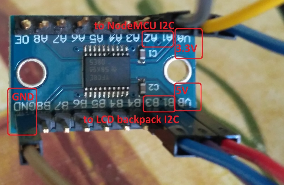

The LCD requires 5V for proper brightness & contrast. You could try to run the LCD at 5V, and the NodeMCU at 3.3V with the pull-up resistors connected to 3.3 V. Or use a level converter for SDA & SCL, with pull-up resistors at both sides.
Receive TXS0108E "I2C Logic Level Converter Bi-Directional Module 5V to 3.3V".
Connect LCD (5V) to NodeMCU (3.3V) through TXS0108E.
Now all is Ok.
Now all is Ok.
