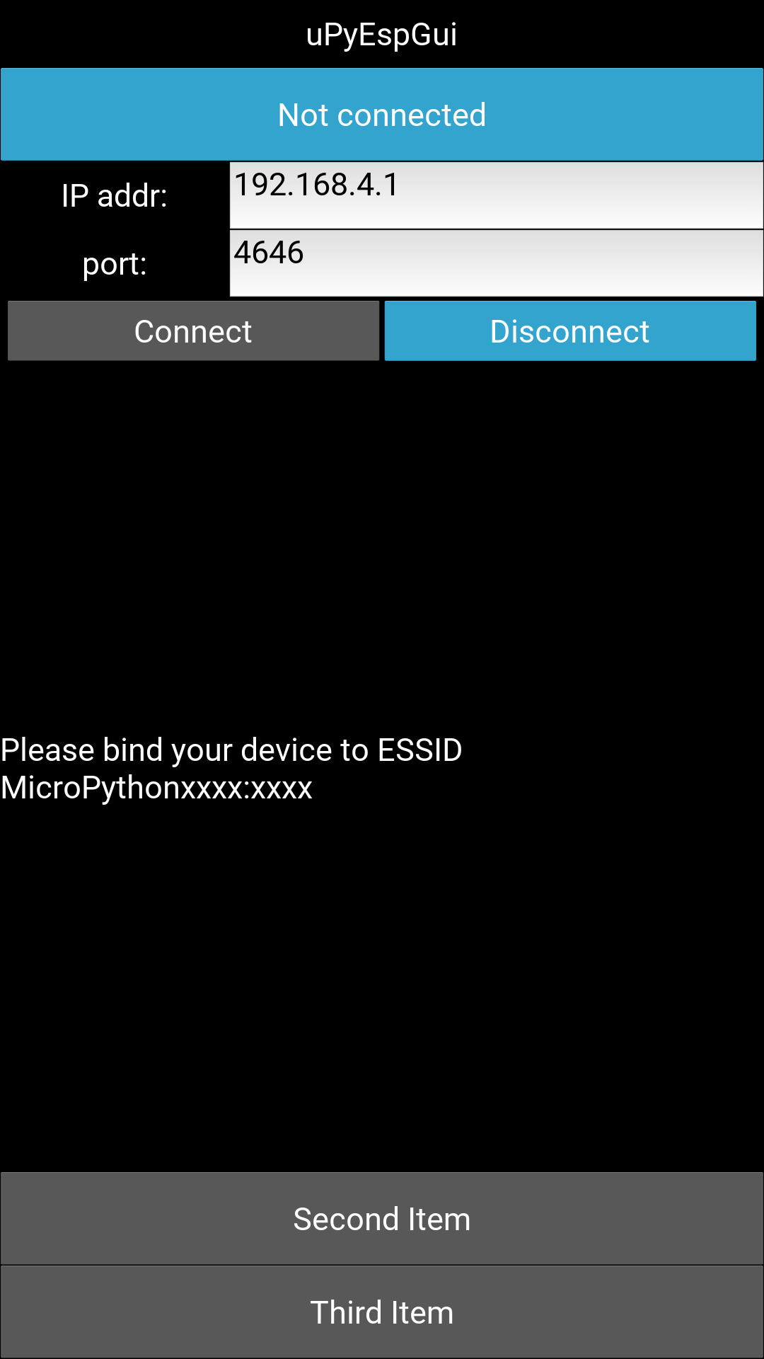

Here is screenshoots of my proof of concept app running on Windows 7 and Android.
If somebody is interested I can share the code, but it's almost an empty shell, only the kv file have a small interest.
In current state it connect to an ESP server via socket, but as the server is blocking waiting for connection, it's completly useless.
The next step is to mature the server side (ESP) with asynchronious communication with websocket, then the server could do it's main task(s) and in the same time communicate with the GUI app, then we get something quite usefull and convenient.

- uPyEspGUI_Android.png (62.6 KiB) Viewed 7559 times
- uPyEspGUI.png (26.54 KiB) Viewed 7559 times
