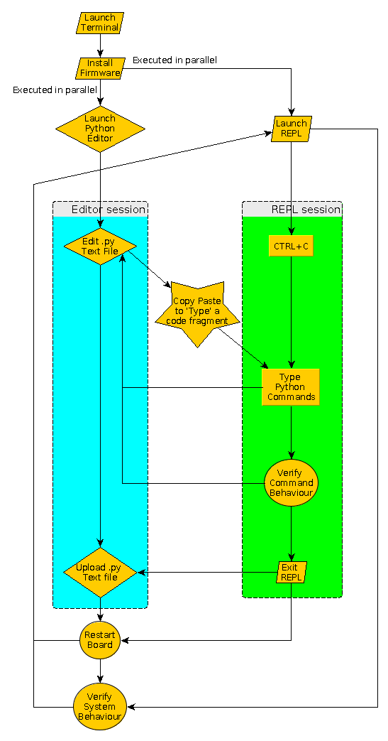

Been trying to organise in my mind the process which I use, to be able to share it with learners and establish the simplest possible tool support for it.
It's something like the diagram below, with the key aspect for learners being the interaction between the editor (where you have 'banked' some python commands) and the REPL, where you can prove what happens when you execute those commands.
I am wondering whether it's better for the "exit to terminal" step (freeing the serial link for upload) is a worthwhile step to be explicit, and perhaps always associated with a restart to prevent false positives or false negatives to do with older modules or object instances still being referred to in the VM.
Reflecting on this has made me question the value of suggesting to the learner that they are still 'in the same REPL session' when perhaps they need to explicitly realise they are not (e.g. that's why any prior references have now disappeared, unless the steps to create them were banked into a main.py or imported module). @jeffmakes what is the cost you perceive for learners having to exit the REPL, trigger a recursive upload, and re-enter the REPL? What is the benefit of doing it from within a single tool? How impactful do you think would be the potential issues from e.g. a module already being loaded, then recursively rewritten on the board's filesystem, but not reloaded since the same VM session is running. Can you see the value for learners if there was a forced restart on entering/re-entering the REPL by default?
To be more explicit, I am wondering whether it makes sense for the 'Restart Board' flowchart node to be placed permanently before the 'Launch REPL' node. However, this would only be proposed as a default setting affect those using the vgkits-vanguard toolchain, when invoking 'vanguard shell' (as per https://pypi.org/project/vgkits-vanguard/ ) . I am not proposing this change at any other level.

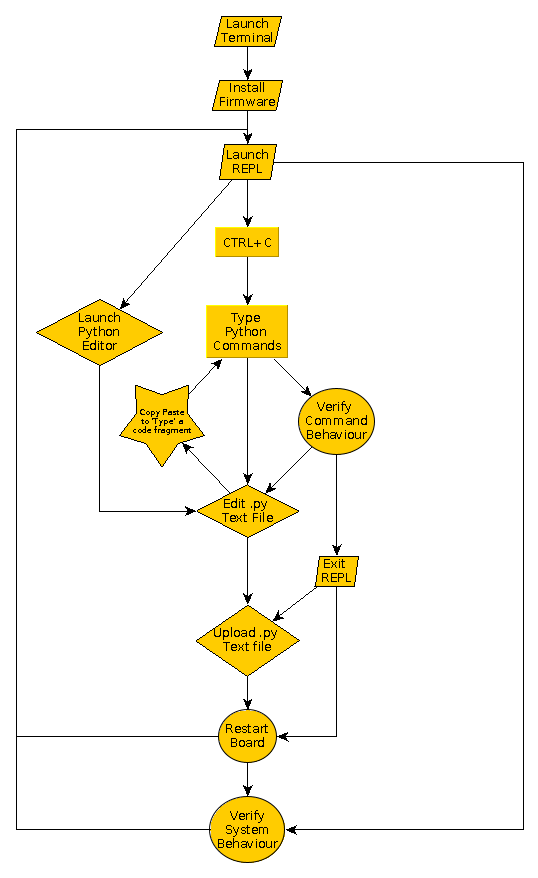

Post by cefn » Tue Jun 19, 2018 1:17 pm
This version of the flowchart might make relationships clearer. Original graphml edited using yed is at https://gist.github.com/cefn/8927a98264 ... d8618175a7
