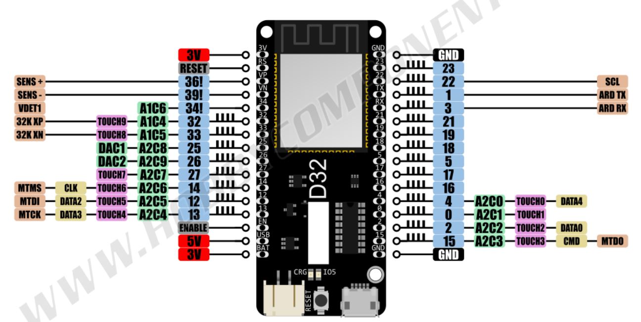

If your only going to be running 10 LEDs you can probably run them from the ESP32 5v pin but wouldn't run larger amounts (Ardunio power supply isn't any better than ESP32).
Do you also have a common ground to both the power supply and the ESP32???
Thank you for your reply
I didn't find any 5V output of the esp32, I guess that you mean I could use the 3,3V output of esp32?
I did not link the GND of the esp32 with the arduino one, I tested it and nothing change.
I tested the apa102 led stripe with fastled on arduino and, I did not have that I wanted, but the led swith on, whereas that with esp32 and micropython_dotstar all led stay off...

Post by OutoftheBOTS_ » Sat May 16, 2020 5:15 am
The LEDs will need 5v supply to run.
You ESP32 board should havea 5v supply from the USB input.
Is this your board??

Post by barbsbou » Sat May 16, 2020 9:10 am
Sure you are right, this is mine. Ok Thank you the
Clearly my connections are simpler thank you...but nothing change obviously.
I really don't see what I am doing wrong...
