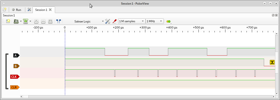

Pulse view.
Screenshot at 2021-03-20 13-25-18.png (32.72 KiB) Viewed 4060 times
