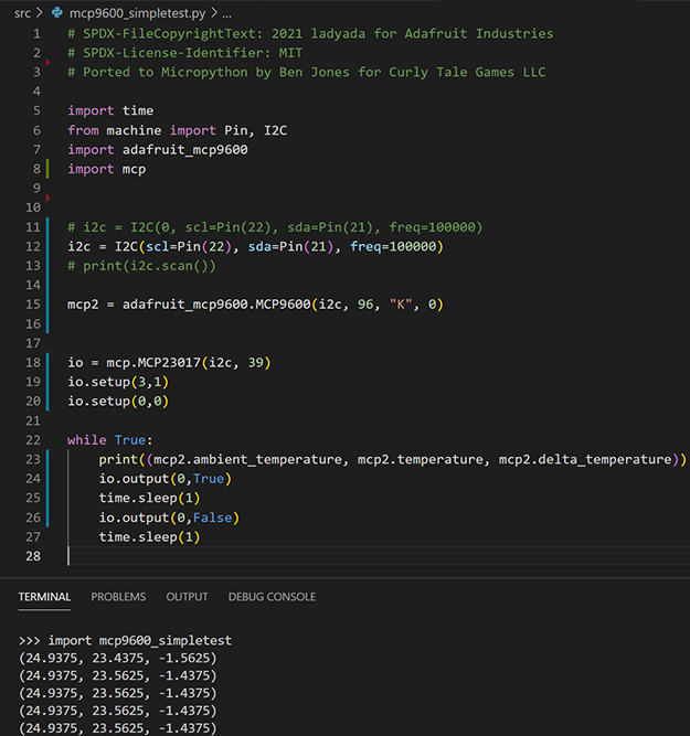

# This what I had before, and it doesn't work:
# i2c = I2C(0, scl=Pin(22), sda=Pin(21), freq=100000)
# This works:
i2c = I2C(scl=Pin(22), sda=Pin(21), freq=100000)
I've pushed an update with that fix to the Github repo.

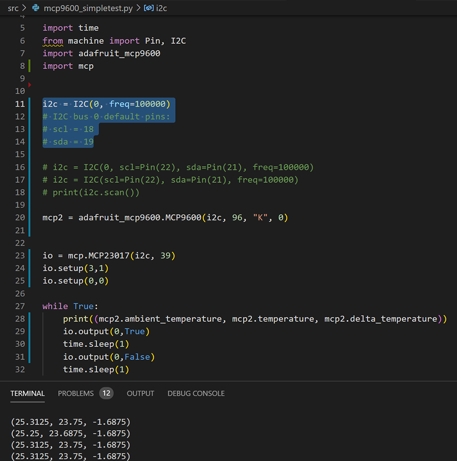

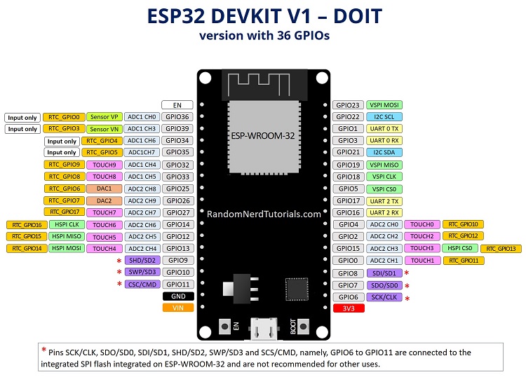

Alright I think I figured it out. The documentation says you can use any pins you want.
https://docs.micropython.org/en/latest/ ... re-i2c-bus
And since most of the examples I found online, as well as the ESP32 pinouts diagrams used pins 21 and 22 for i2c, that's what I was using:
When I switched my code to be:
i2c = I2C(0, freq=100000)
# I2C bus ID 0 default pins:
# scl = 18
# sda = 19
I got 100khz for the frequency:
I think there must be an issue with the I2C class and specifying the I2C bus ID and I2C pins. I feel like that's a bug in Micropython, or at the very least the documentation should be updated so people know that you will get slower speeds if you don't use the default bus i2c pins, and you will get very slow speeds if you define both the bus ID and the I2C pins.
I posted this as an issue on the Github repo:
https://github.com/micropython/micropython/issues/7524
