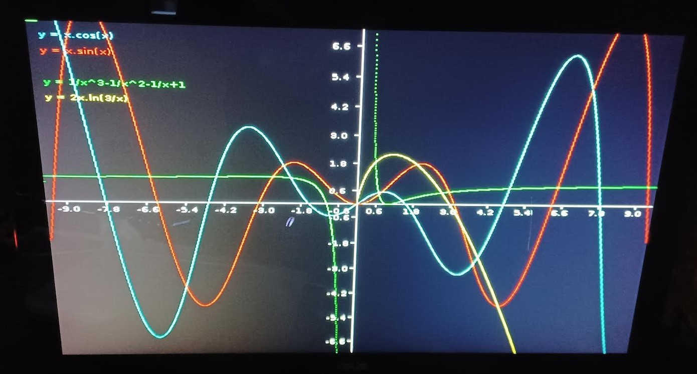

well when i see you guys on this forum i really feel like i am a beginner. This thing took me 2 weeks and a lot of thinking (and also a scope). I turned 50 recently and I am totally amazed by the capabilities of such a small device.
I think this pico can do more than the CPC 464 i've had on my 14th birthday. To make sure of this I implemented a simple font and draw some nice plots !!! (see below)

there is no VGA board, the pico GPIO pins are connected directly to the VGA cable via 300ohms resistors to drop the 3.3V to 0.7V on the red/blue/green inputs, and 47ohms resistors for impedance adjustment on the Hsync/Vsync inputs.
It is connected to the VGA cable via a simple header (see here) and that is maybe what you think is a separate board.
There is nothing more on the picture. The black square-shaped thing you see on my breadboard is a 3.3v lithium battery which is not related and not wired to anything.
