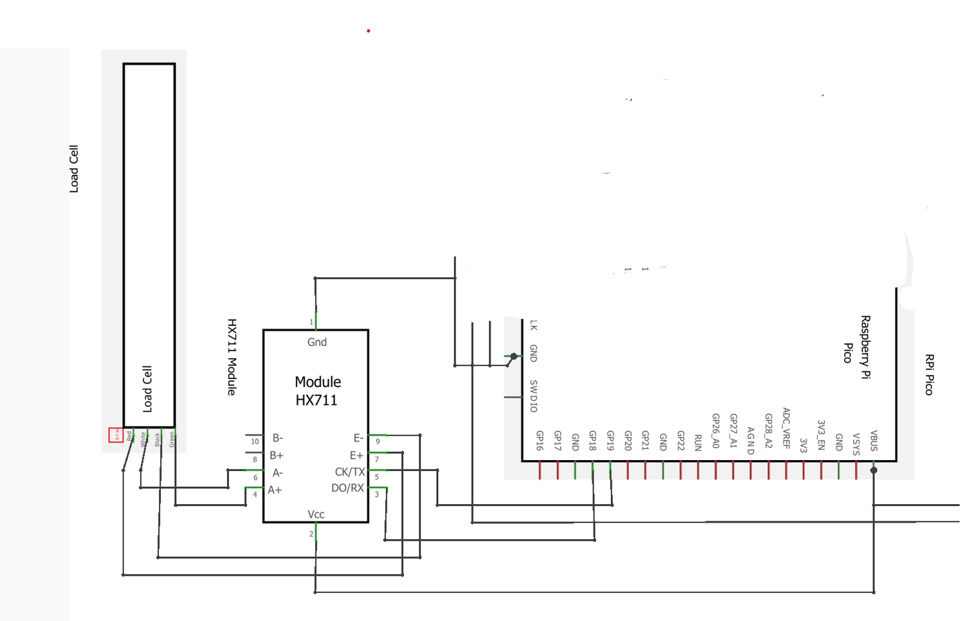

hello there,
This is the schematic diagram for the load cell with pico.
this could give you a clear understanding of the connections.

Re: HX711 - which lib should I use?
Post by Roberthh » Thu Aug 04, 2022 4:39 pm
Just to repeat myself: the schematic diagram shows, that you connected the hx711 to GPIO18 and 19. Therefore, the Pin definitions must be:
pin_OUT = Pin(18, Pin.IN, pull=Pin.PULL_DOWN)
pin_SCK = Pin(19, Pin.OUT)

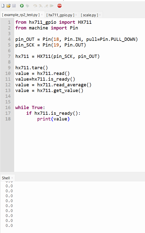

Post by likith1268 » Mon Aug 08, 2022 9:05 am
yes, thanks for your reply.
I have changed the pin connection in the code and when i am trying to calibrate it's not working
when i am running the example_rp2_test.py file , it giving me all zero's
and when i am running scale.py file, it gives me a error saying type object 'SPI' has no attribute 'MASTER'
i am attaching the files below, please look at it.
Post by Roberthh » Mon Aug 08, 2022 9:40 am
You should read new values in the 'while True' loop, for instance with:
value = hx711.get_value()
Otherwise it will print always the same number. And you cannot use the SPI variant of the driver without changing it. It was made for the Pycom variant of a ESP32 based MicroPython.
