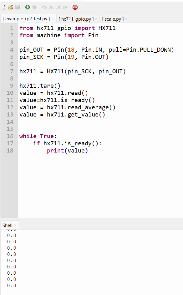

I tried adding the code in the while loop which you gave, but getting the same zeros in the output.
I need the weight of the product as the output but it's showing all zeros.
Re: HX711 - which lib should I use?
Post by Roberthh » Mon Aug 08, 2022 3:01 pm
So I hooked up a HX711 to a Pico again. Test script:
from hx711_gpio import HX711
pin_OUT = Pin(18, Pin.IN, pull=Pin.PULL_DOWN)
pin_SCK = Pin(19, Pin.OUT)
hx = HX711(pin_SCK, pin_OUT)
hx.set_gain(128)
time.sleep_ms(50)
hx.tare()
    if hx.is_ready():
        print(hx.get_value())
    time.sleep(0.1)
First few lines of output:
10.5625
11.6875
2.03125
2.03125
3.03125
10.53125
13.65625
18.25
-3.546875
-32.14063
-27.34375
-21.75
-22.79688
-26.57813
-32.67188
-36.73438
-31.03125
-20.25
-9.421875
8.203125
Do you have a load cell connected to the HX711?

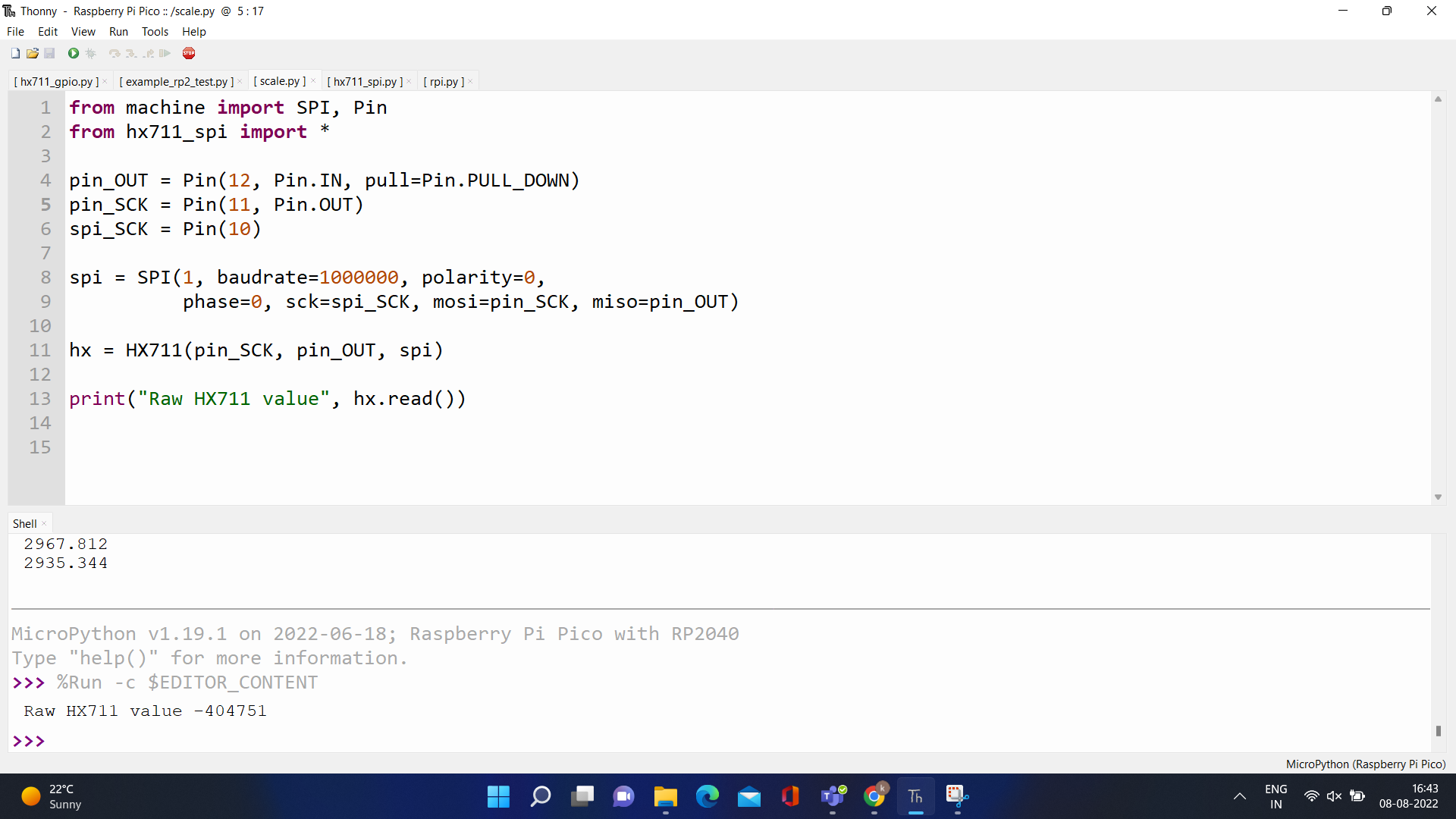

can we know how to calibrate the values, I have attached scale.py offset values which is -404751.
can you please help with that thing too, it would be so great if you could help with this.
Screenshot (112).png (190.78 KiB) Viewed 9471 times

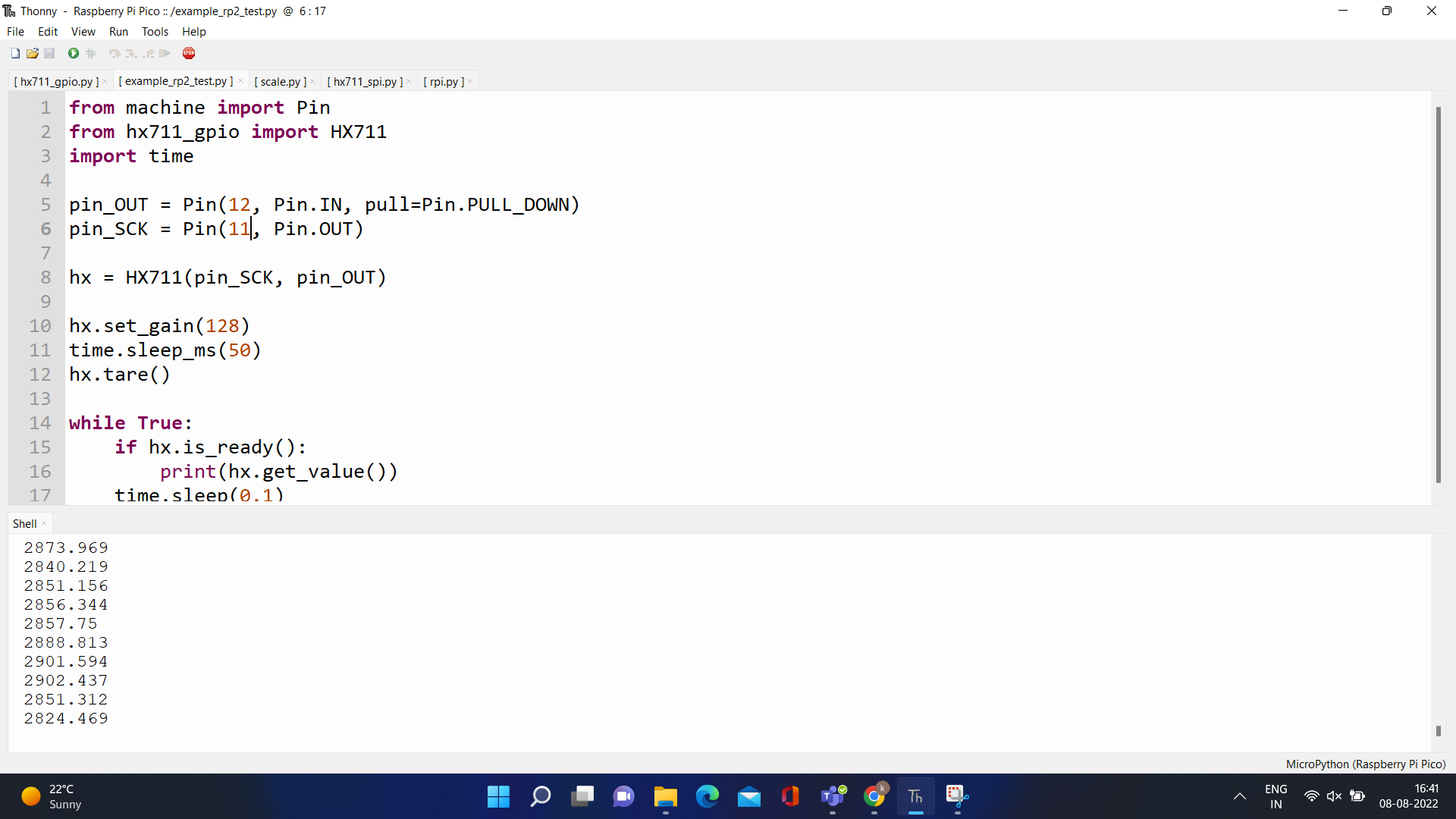

sorry to bother you again, but I need some clarity on calibration thing.
so, when I am running example_rp2_test.py file it's printing the value continuously with different numbers and simultaneously, i am getting one value when running scale.py file (this is without load)
lly, when applied load the readings are increasing acccording to load.
so, may i know how to take the offset value??
is the output which i got by running scale.py is the offset value???
Screenshot (112).png (190.78 KiB) Viewed 9443 times
Screenshot (111).png (188.72 KiB) Viewed 9443 times
Post by Roberthh » Mon Aug 08, 2022 7:20 pm
hx.tare() take the sensor reading at the time of the call and subtracts it from all following readings. This value is internally called offset. What I am curious about is, that even after call hx.tare() the following readings are ~3000. They should be around 0, at least when the series starts.
