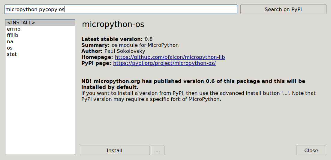

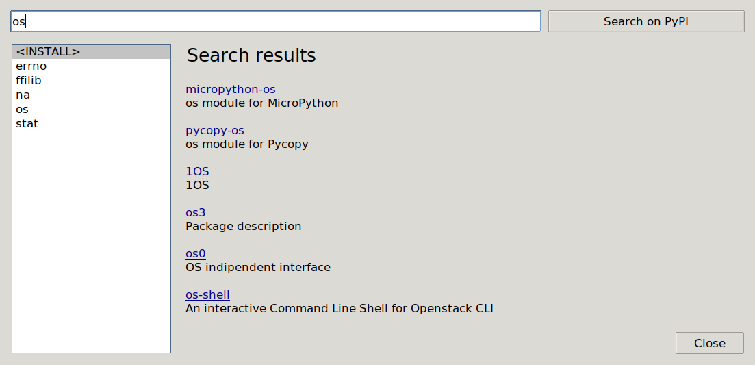

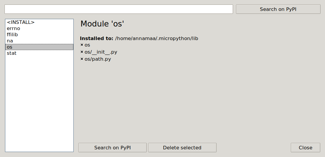

Here is my take on MicroPython GUI for micropip.py.
With CPython the user can browse distribution packages, but since metadata is lost with MicroPython, the dialog allows browsing top-level modules from [path for path in sys.path if 'lib' in path] instead: The search function brings "micropython-" and "pycopy-" packages to the top even when searched without prefix: For "micropython-" packages the main metadata is queried from PyPI, but if the package also exists at micropython/pi, the reminder is added about micropip.py preferring this version:
I modified micropip.py a bit so that user can specify version to install when she is happy to install from PyPI: https://github.com/aivarannamaa/micropy ... 0be6f71c0b
All this works with local MicroPython, remote MicroPython over SSH and bare metal MicroPython (in latter cases micropip installs to a temp dir which will be then uploaded). I hope to get beta out by the end of next week.
Looking forward to hear your comments (and spelling/grammar fixes for the UI strings)!
