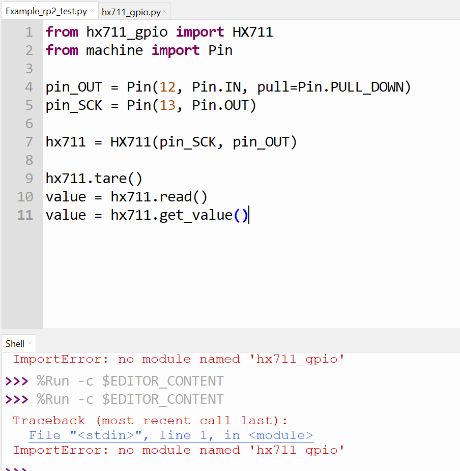

Hi there,
we are working on 1kg load cells and HX711 amplifier. I have tried multiple source codes to run on raspberry pi Pico. however unfortunately, it's giving me error in scales.py or using as a separate .py file also I tried to combine the HX711 py file and added the scale.py/test code together, but it still gives me error.
can you please direct me to the source code for programming HX711 with load cell for raspberry pi Pico using micro python?

I know that the code I provided (No 1 in your list) works. So which error do you get in scale.py?

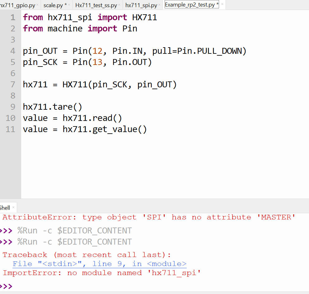

Hx711_gpio works perfectly fine but when running a scale.py it gives: no module name 'Hx711_gpio'. Also, tried combining the codes Hx711_gpio and scale.py but give me error: type object 'SPI' has no attribute 'MASTER'.
please give me some suggestion.
Re: HX711 - which lib should I use?
Post by Roberthh » Tue Jul 19, 2022 2:09 pm
The scale.py code is written for a Pycom board and does not match the other files. For a RPi Pico, the spi instantiation must be changed. But maybe just go for the examples in README.md

What type of changes do I have to make on hx711_spi.py file, can you specify please? As I have tried the example code for Pico RP2040 also there is a same directory it still gives me error.
I have attached an error image please go through it.

The source code snippet and the error message do not match. Besides that, for the GPIO mode, you have to use:
from hx711_gpio import HX711.
And obviously, the hx711_gpio.py file has to be in the file system of the board.

still getting the same error after placing the hx711_gpio.

The message says: File not on the board or not in the search path. The file has to be in the file system of the RPi pico, not on the PC.
