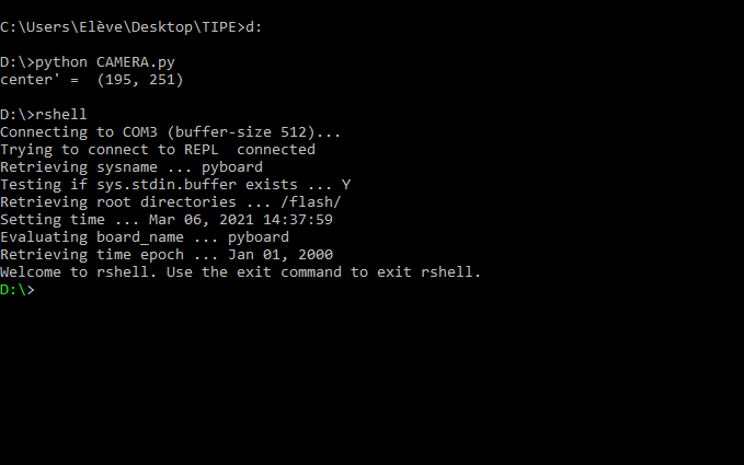

I encountered a problem using rshell :( . In fact, I am on windows 10 and I am using a batch file to automate command lines (4 lines in all). The 3 rd line involves the rshell. Only here, once I am correctly connected to the rshell, the last line is not carried out.
Do you know why ? If yes, how to fix it?
I leave you a screenshot attached.
Here are the command line:
d: #in order to connect to the correct disk
python CAMERA.py #run a python script using the webcam
rshell #in order to connect to the pyboard
repl ~ exec(open('motor.py').read()) ~ #run a script on the pyboard allowing to run motors
Thank you in advance for your help!

You should be putting the repl command on the same line as the rshell commnad. So:
rshell repl "~ exec(open('motor.py').read()) ~"
Normally, I would use import rather than exec. i.e. use:
rshell repl "~ import motor ~"
I'm not exactly sure about the quotes when using windows, but they're definitely need on Mac/Linux.
The way you've show things, rshell will be launched and once you press Control-D to exit, it will then resume running the script and probably produce an error because it doesn't know what the repl command is. For example, I created hello.py with the following contents:
print('Hello World')
print('Sleeping for 10 seconds')
time.sleep(10)
print('After sleep')
and running this shows:
$ rshell 'repl ~ import hello ~'
Connecting to /dev/cu.usbmodem3389337E34332 (buffer-size 512)...
Trying to connect to REPL  connected
Retrieving sysname ... pyboard
Testing if sys.stdin.buffer exists ... Y
Retrieving root directories ... /flash/
Setting time ... Mar 10, 2021 15:35:27
Evaluating board_name ... pyboard
Retrieving time epoch ... Jan 01, 2000
/Users/davehylands/micropython/upy-examples> Entering REPL. Use Control-X to exit.
MicroPython v1.12-210-g1993c8c-dirty on 2020-02-29; PYBv1.1 with STM32F405RG
>>> import hello
Hello World

Hi Dave,
Thanks a million !! :D
It works !
(And just to let you know: the command works also without quotes on windows )
