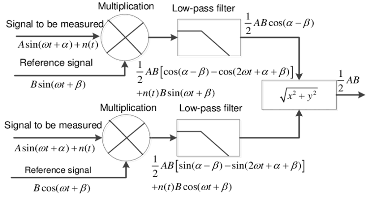

Now I tried to do it using Ad9833 wave generation module. But I could not change 11,12 and 15th lines in the test code here according to Esp32.I was able to generate the signal with arduino-Esp32. but I couldn't do it with micropython.
my main goal is actually implement of this lockin amplifier block diagram. What do you think. I've been struggling with it for over 2 months.
Can it be done or should I give up? I depressed and tired thank you

Post by pythoncoder » Sun Feb 20, 2022 1:38 pm
It rather depends on the frequency you want to measure. Also, as I said above, I have my doubts about the ESP32 for this type of application.
