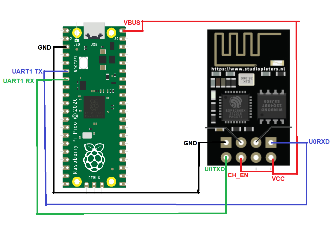

Hi everyone,
I have a rp2040-zero connected to a esp8266 wifi chip.
I want to turn it into a web server to activate a switch from the webpage and i actually found a few examples lying around...
The main problem starts at the imports, as with every example i try to implement, i always get the same result:
"Umport esp" doesn't work,
"import network" doesn't work,
"from network import WLAN" doesn't work
And also "import socket" doesn't work.
From my googling I come to think that my micropython should already have these libraries, while my board for some reason doesn't....
I've teied to look for the ".py" files it was missing, updating firmware from thonny, updating firmware manually to the latest version, but nothing.
Still stuck and I hope I'm not alone and that there's someone who can help me out here.
Thank you in advance!

Doesn't work means I get the following error:
ImportError: no module named 'network'
And the same for all the other libraries mentioned...
It's not the esp8266 module the problem, but rather my rp2040-zero not having the libraries that i should need to then interface with the WiFi chip.

Post by Frenk.98K » Wed Jul 27, 2022 12:31 pm
Yes, but with the power of gpio pins, I've added a esp8266 chip... Picture below, only imagine it's a rp2040-zero on port 0 and 1 instead of a pico
There must be a way to use WiFi and the network library if these esp boards exist and all say are compatible with pi and arduino, right?

Re: Esp8266 Web Server
Post by karfas » Wed Jul 27, 2022 1:39 pm
Frenk.98K wrote:
Tue Jul 26, 2022 11:26 pm
Hi everyone,
As we now know what you are trying to accomplish, I would recommend to create the web server on the 8266 and set your contact from there.
If the Pico also needs control, you could connect one ESP output to a Pico input.

Post by Frenk.98K » Wed Jul 27, 2022 3:55 pm
Ok so if I'm understanding this correctly, the esp8266 in the picture it's actually it's own thing?
Like I can connect with some serial to USB and put code in that through my computer?
And so in this case it would then become the wifi module doing it's own wifi thing and then exchanging data and commands with the rp2040 through UART?
I have no idea what the "esp8266 on the picture" is. And yes, they are normally (even in some cheap network-enabled wall plugs) programmable when you attach a usb/uart or rs232/uart converter.
To use the ESP network from the pico (as in your picture) you need most likely special firmware on both sides, as others also pointed out.
