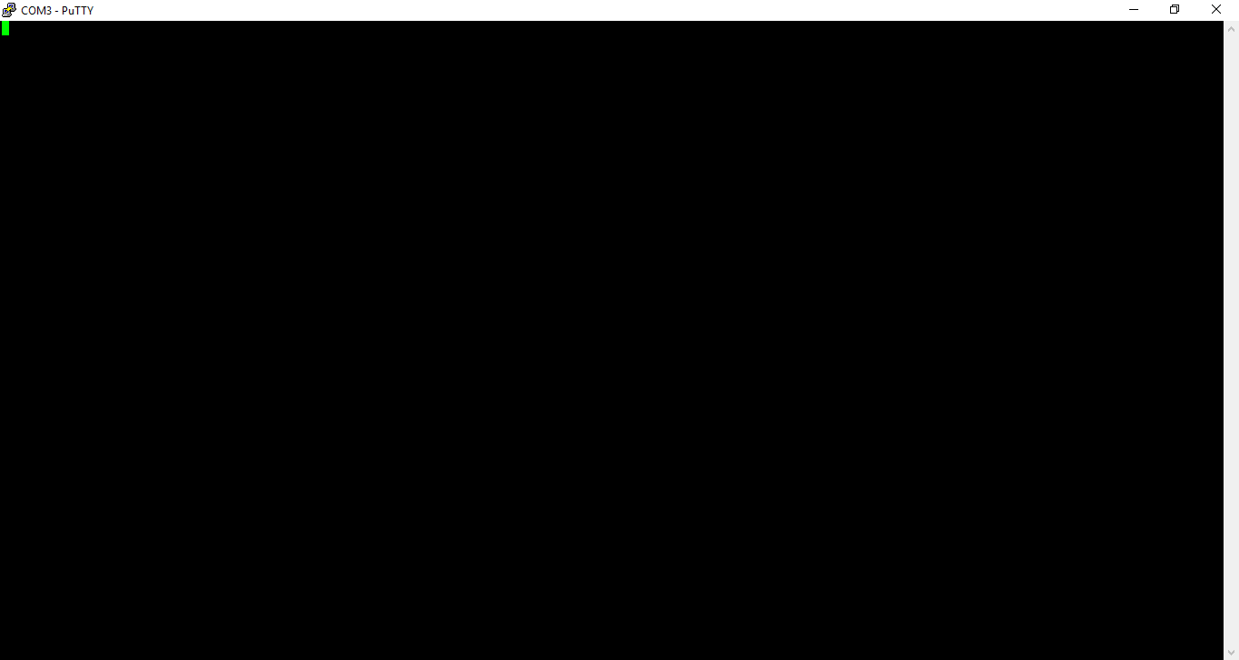

Thank you for the reply. I erased the memory before flashing it. The chip that I'm using is a generic ESP-07. I have attached a screen shot of the onboard repl when I attempt to connect through putty.

How much flash memory does your board have? When you flash the firmware, are you using the --verify argument? If the board doesn't have sufficient flash to install the firmware it could explain your problem - but in this case --verify would tell you that it had failed.

I also flashed some raw boards with a ftdi breakout board attached.
What happens if you leave the putty connection open and powercycle the ESP board?
Did you get any output?
Did you also checked your settings for the serial connection? Especially the flow control option?

Did you disconnect the pin that turns the bootloader mode before powering it back up after flashing? Reset the chip while connected via putty, you'd be able to tell if it's still in bootloader mode if it prints garbage.
