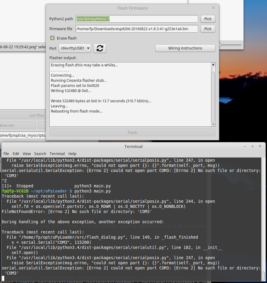

I am at home now... working on Linux Mint and have similar problems... look at picture... I have certainly no special characters in path only ASCII....
I don't know how to add picture... :lol: ...
...finally...wrong name :D
NOTE1: ...BUT esp8266 is flashed OK
NOTE2: ...Further communication on github

profra wrote:I am at home now... working on Linux Mint and have similar problems... look at picture... I have certainly no special characters in path only ASCII....
Ooops, actually the screen from your linux is showing another issue. I have, by mistake, hardcoded "COM3" port into rebooting routine that should bring ESP to normal working mode after flashing. But of course there is not such port on the Linux, so crash++. I have now fixed both issues, the errors in encoding should be silently ignored. It's hard to test if I can't reproduce it, so please report back if there are any more issues.
