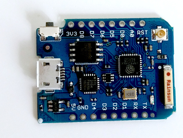

So my board arrived and it indeed is a 4-layer PCB. I will post photos and test results shortly.
Re: WeMos D1 Mini Pro 16MB
Post by deshipu » Wed Sep 14, 2016 8:40 am
OK, so here are some first simple tests.
I have flashed the latest master of MicroPython and this module, and it seems to work fine (no surprises there).
As you can guess per https://github.com/micropython/micropython/issues/2335, it doesn't actually see 16MB of flash memory. It sees it as 1MB.
Info from port_diag:
>>> import port_diag
FlashROM:
Flash ID: 1840ef (Vendor: ef Device: 4018)
Flash bootloader data:
Byte @2: 02
Byte @3: 20 (Flash size: 1MB Flash freq: 40MHZ)
Firmware checksum:
md5: 81b350413dfda43fdce2fe7dc40e727e
True
Networking:
STA ifconfig: ('0.0.0.0', '0.0.0.0', '0.0.0.0', '208.67.222.222')
AP ifconfig: ('192.168.4.1', '255.255.255.0', '192.168.4.1', '208.67.222.222')
Free WiFi driver buffers of type:
0: 8
1: 0
2: 8
3: 4
4: 7
lwIP PCBs:
Active PCB states:
Listen PCB states:
TIME-WAIT PCB states:
Some photos:
