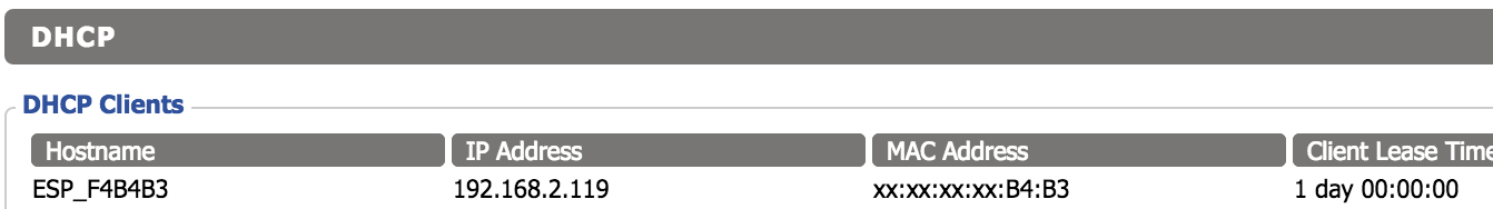

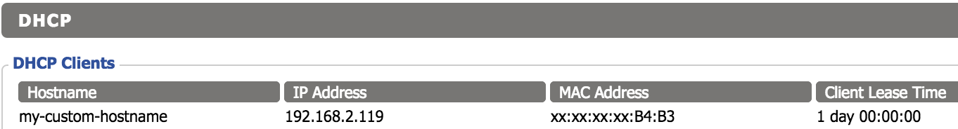

The device should show up in your router's client list with the specified hostname (before and after pictures):
Screen Shot 2016-10-30 at 11.52.20 AM.png (30.14 KiB) Viewed 90463 times
Screen Shot 2016-10-30 at 11.53.33 AM.png (31.28 KiB) Viewed 90463 times
