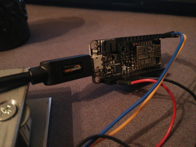

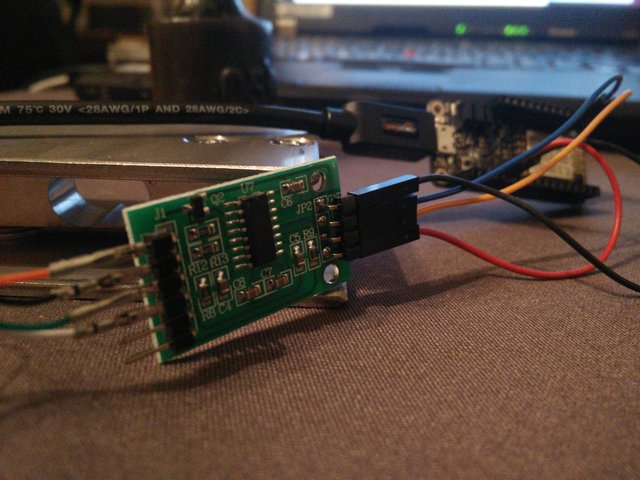

I have two pictures of my setup, too.
Has anybody a digital scale working? That board is seemingly ubiquitous and the very same hardware works with my Arduino. So it _must_ be my code -- maybe someone spots a problem?
