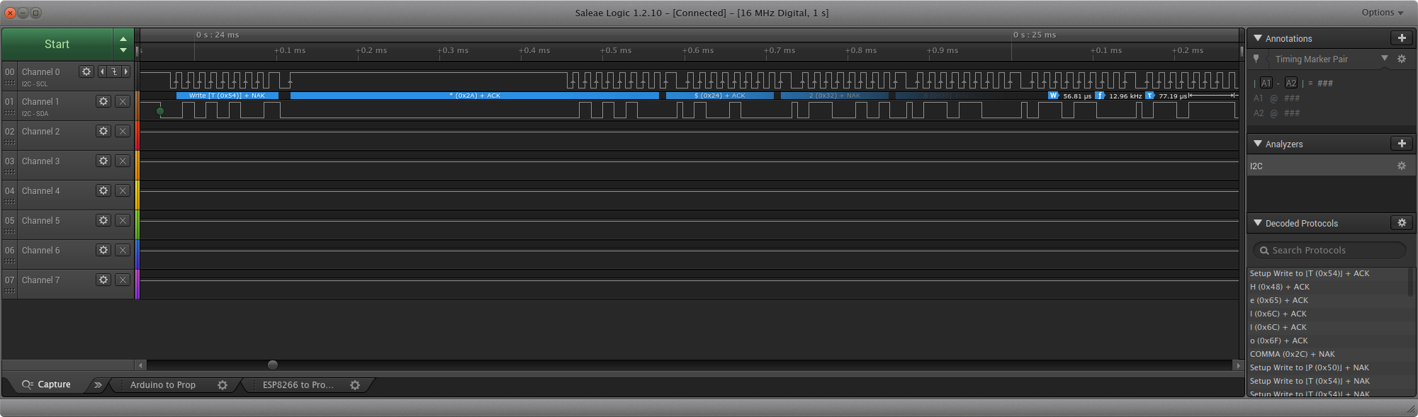

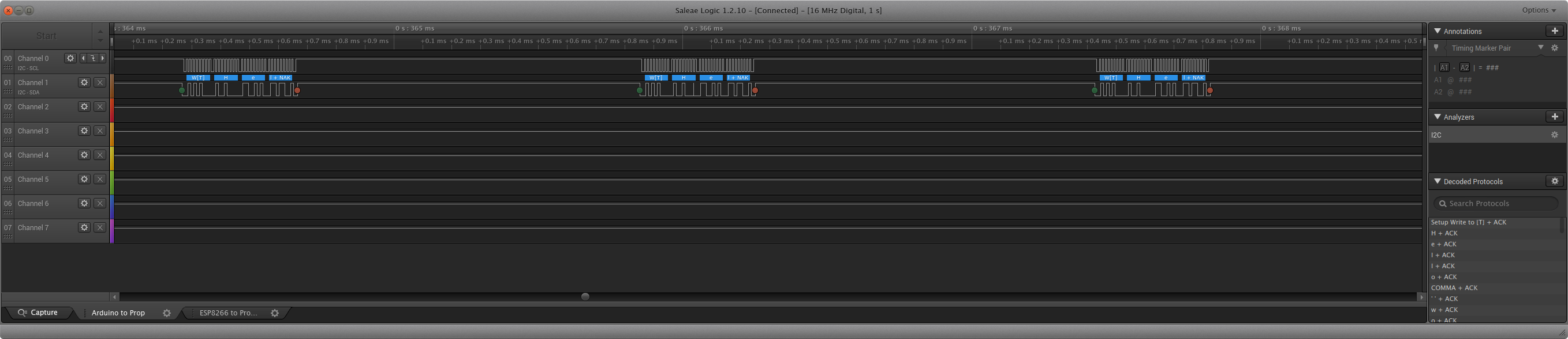

Okay... this has been an interesting day of messing around with I2C. I'm guessing the problem is that I have two bit-banged I2C routines, neither one matches specifications perfectly, and together they're doing terrible things to each other.
Setup
Broken:
Parallax Propeller running a bit-banged I2C slave @ address = 42
ESP8266 running machine.I2C @ 100 kHz with this code in main.py:
Less broken:
Arduino Leonardo running "Wire" class with this software:
Problem
The ESP8266 seems to be having some trouble writing the address once in a while. When that happens, the whole comm chain breaks down into chaos. Here's the beginning of a large capture: You can see it starts out doing well until the Propeller hiccups and throws a NAK, but then something really bad happens in the second attempt. The address is all screwy, with one of the bits being just a blip instead of a full period.
Here's a snippet from the middle of the capture: So the stop bit is missing, causing the whole protocol to degrade and now my logic analyzer has no idea what's going on. Who knows if the Propeller and ESP8266 are interpreting SDA in the same way as the LA at this point.

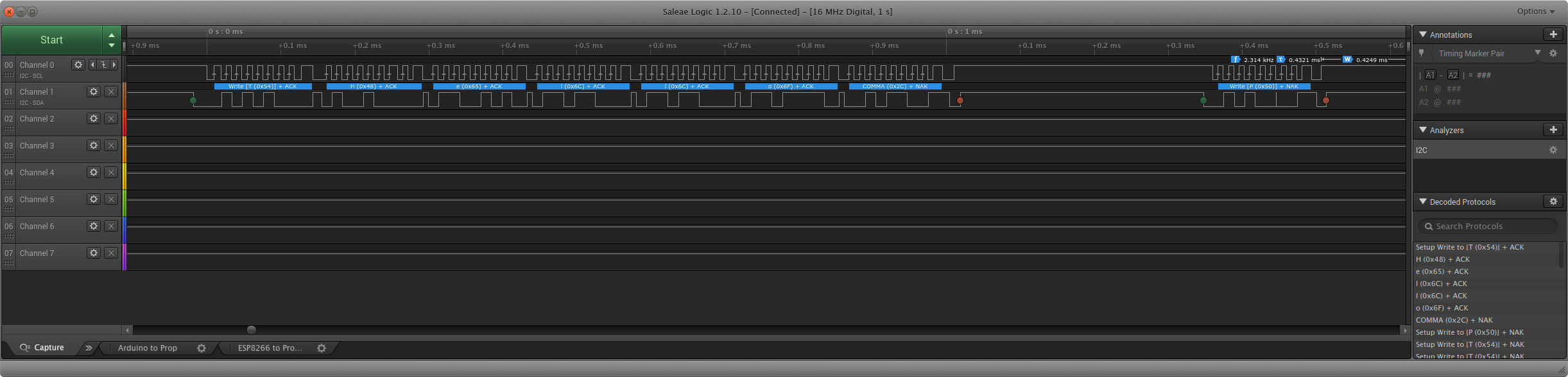

The Propeller's slave software clearly is not perfect, as evidenced by the first NAK in the first picture. However, it gives that same behavior when controlled by the Arduino, but without the eratic behavior. For instance, here's the first few lines of output from the Arduino serial terminal:
Okay, clearly the Prop software isn't perfect. But here's what part of the capture looks like:
We can see the Prop still throwing NAKs for no good reason, but behavior is reasonable. The master retries the write routine again (correctly) and eventually succeeds.
I2C Scanner
2 number of tries required.
1 number of tries required.
11 number of tries required.
6 number of tries required.
8 number of tries required.
So where do I go from here? Has anyone else seen this kind of behavior from the ESP8266?
