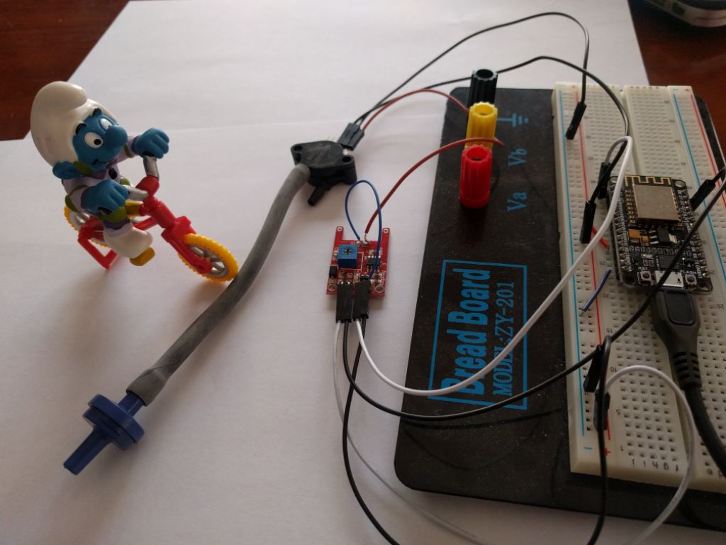

I just rembered this post from a while back and thought I must finish it up if other forum users search up similar questions.
Many thanks @hase, @pythoncoder and @roberthh for the help and encouragement to dabble into Schmitt triggers. I spent some time reading about them and then realised that these electronic circuits are already present in many of our cheap sensor devices to prevent constant bouncing.
So I grabbed a very cheap rain sensor unit, detached the rain sensor from the control module and connected it to the output of a MXP5100DP measuring a change in air pressure as a cyclist passes over a hollow rubber tube. I then played with the potentiometer until a got a clear pin state change. The one I used was great as it has an analog pin output too.
In conclusion, I didn't try to trigger an interrupt on an analog pin change, instead I ran the analog signal through a schmitt trigger to obtain a reliable digital output and ran an interrupt from that.
My terrible code is below.
Obvious next steps are to place two rubber tube sensors a known distance apart and identify only bicycles, count bicycles by direction, calculate speed, etc, etc.
