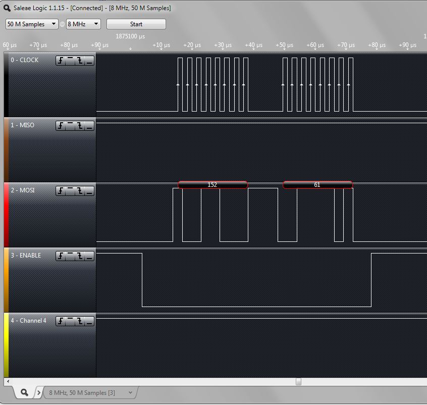

For my project I must send to the vocal syntetizer two data , a command 152 followed by a number between 0-254 that represent which voice I want activate.
This is the code used on PyBoard and how the SPI send data on MOSI line :
# Collegamenti interfaccia MOSI
# mosi   pin x8 (interf 1)  y8 (interf 2)
# clock  pin x6 (interf 1)  y6 (interf 2)
#chip selection
# cs1   pin y4
# cs2   pin y5
# cs3   pin y6
# cs4   pin y7
import math
from pyb import Pin
from pyb import SPI
spi = SPI(1,SPI.MASTER, baudrate=600000, polarity=0, phase=0, bits=8, firstbit=SPI.MSB)
print(spi)
cs1 = Pin('Y4', Pin.OUT_PP)
cs1.high()
cs2 = Pin('Y5', Pin.OUT_PP)
cs2.high()
cs3 = Pin('Y6', Pin.OUT_PP)
cs3.high()
cs4 = Pin('Y7', Pin.OUT_PP)
cs4.high()
      spi.send(b'152')
      spi.send(b'61')
      pyb.delay(1000)
This is how data are transmitted on MOSI ( data are showed as decimal value).

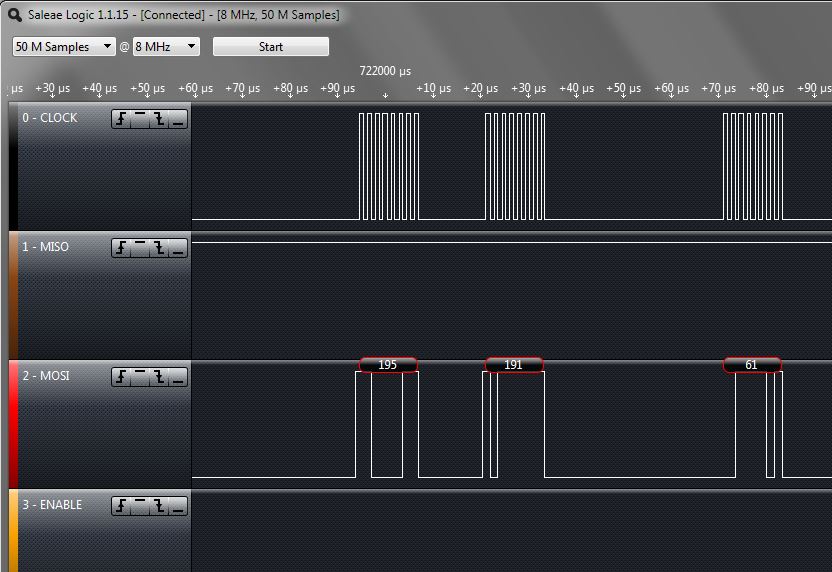

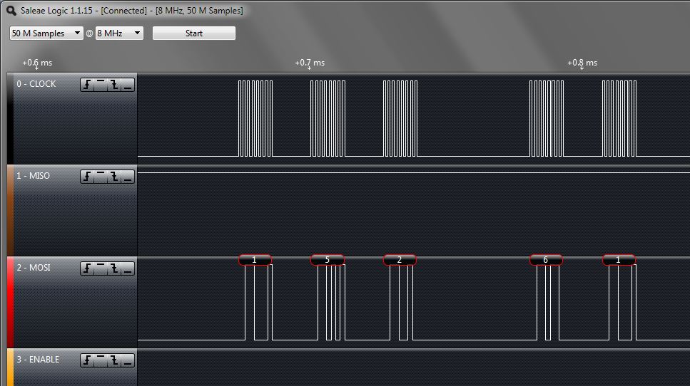

Implementing a similar code on ESP8266 I've some problems because seems that SPI work in a different way .
This is the ESP8266 implementation:
import utime
from machine import SPI
spi = SPI(1, baudrate=600000, polarity=0, phase=0)  #  HW SPI
#spi = SPI(-1, baudrate=600000, polarity=0, phase=0, sck=Pin(14), mosi=Pin(13), miso=Pin(12),firstbit=SPI.MSB)
print(spi)
cs1 = Pin(2, Pin.OUT)
cs1.value(1)
cs2 = Pin(16, Pin.OUT)
cs2.value(1)
cs3 = Pin(0, Pin.OUT)
cs3.value(1)
cs4 = Pin(15, Pin.OUT)
cs4.value(1)
      cs1.value(0)
      spi.write(b'152')
      spi.write(b'61')
      cs1.value(1)
      time.sleep_ms(550)
This is how the SPI transfer the data ( values showed as decimal value):
ESP8266 split the values in single byte and send 3 byte for 152 and 2 for 61.
At this point I've tried to send ASCII characters equivalent to 152 (ÿ) and 61 (=) instead than declare the decimal value, and this is what happen if i change the code as :
spi.write(b'ÿ')  #ascii 152
          spi.write(b'=')  #ascii 61
In whch way can I solve the issue ?
Is it due to different board hw or is something related to micropython implementation ?
Thanks Roberto.

A couple of points. Firstly, you can use the machine module on the Pyboard. This would enable you to run the same SPI code on each, facilitating a direct comparison.
Secondly, you need to be clear exactly what you need to send to the device. b'152' is a 3 byte string whereas b'\x98' is a single character of value 152. Which does the device actually require?
You may want to experiment at the REPL to get a handle on this.
>>> b'\x98'[0]
152
If you do need to send two characters, consider a bytearray:
a = bytearray(2)
a[0] = 152
a[1] = 61
spi.write(a)
I'd avoid using characters like 'ÿ' in code. Extended ASCII may not always be handled correctly in editors/IDE's and suchlike.

Post by BOB63 » Mon Aug 27, 2018 6:44 pm
Hi Peter,
about the first point I'll try to do what you suggest and use on Pyboard the machine module instead than pyb module.
About the second point my voice synt require to receive just one byte with the command /x98, followed by another byte ( between 0 and 254 dec) .
On some examples code of Voice synth , I've seen that was used to send the decimal value 152 instead than hex value, so on pyboard using the pyb module I've seen that was working in the same way.
I was not aware that was possible send as bytecode an hex value and due that using on the Pyboard the pyb module spi was working correctly sending the decimal value instead that hex value , I was totally in confusion .... :roll:
Now on the code for ESP8266 as you suggested I've changed the code as below , sending the hex value , and now it works
Thank you so much as ususal !
